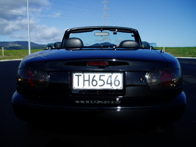

Color: Smoke black
1 Remove the lights first!
2 Clean them down with an alcohol solution ( bourbon won't work ) or a dustless Terry cloth, but be thorough!
3 Place the items on a dust free table or card board sheet
4 Start with a light continuous stroke from one side across to the other over lapping each stroke as you make your way down.
5 leave to dry for atleast half an hour between coats on a cold day.
**TIPS**
Don't go too heavy on the first coat!
Also don't go too heavy on all coats to avoid the runs
Good luck You can get a good result with care and patience.
