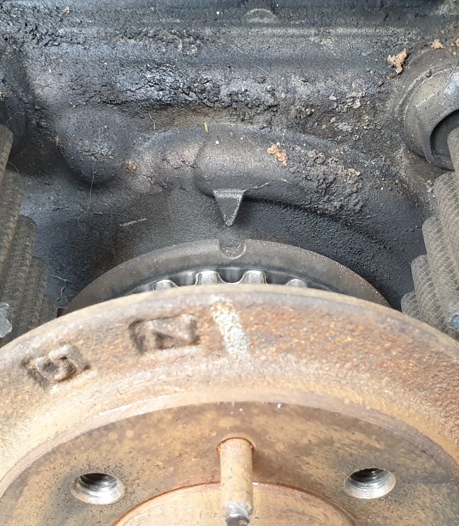

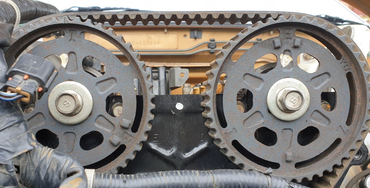

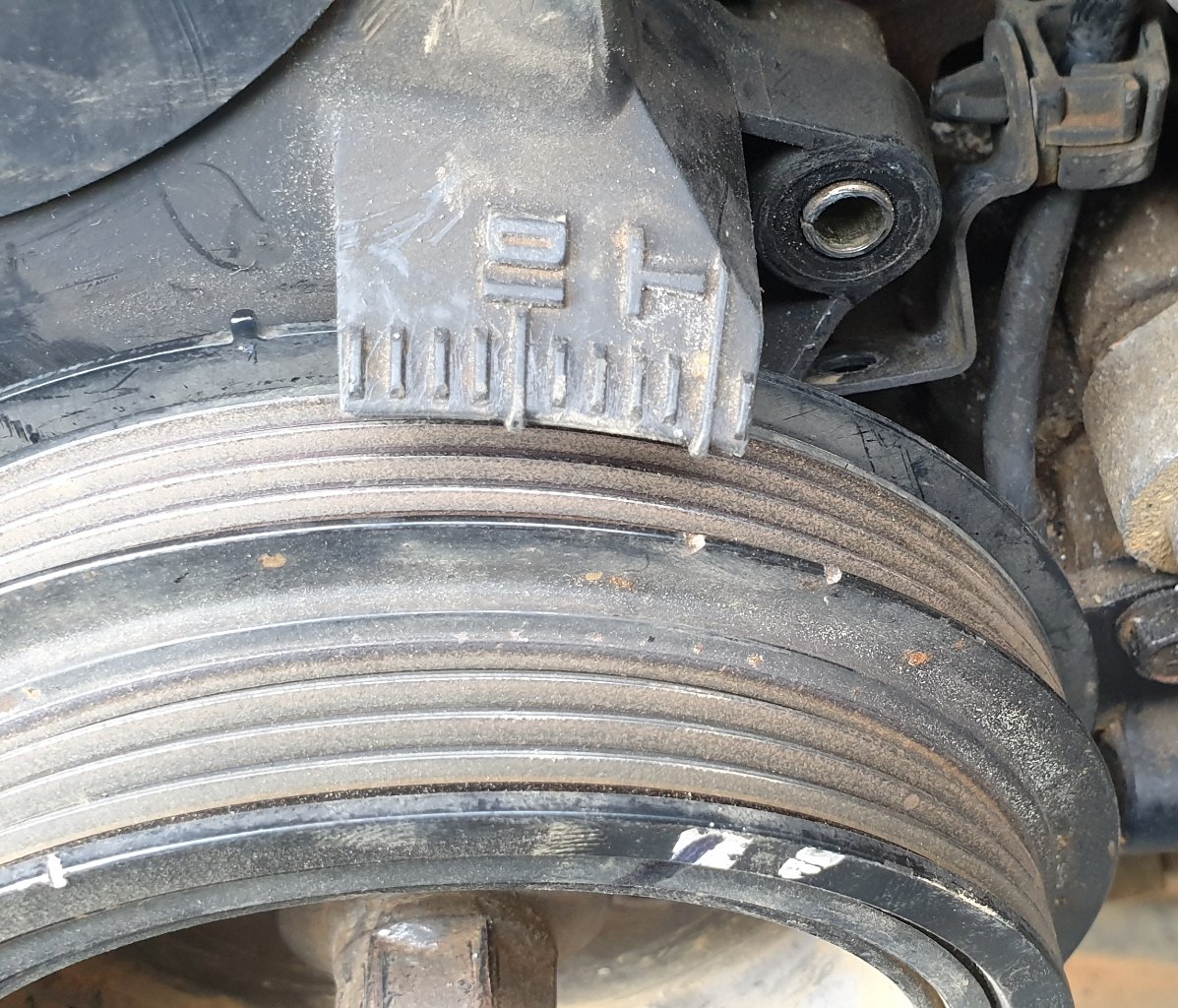

Hi folks, do iv just replaced the head gasket on my 1800 98 mx5, now i cant get it to start.
Iv checked the timing 5 times, all good but when i put the plastic cover on and then the crank pulley ,the marks are way off the pointer.
Any ideas
Re: Timing issue
Post by Keith Jones » Wed Oct 28, 2020 9:44 am
It looks as if you have done everything correct with the timing.
The cams and crank are aligned correctly and the T on the plastic cover is lining up with the TDC notch on the pulley.
So the reason it isn't starting must be elsewhere.
Have you checked that it has a spark when cranking and that it it getting fuel OK?
