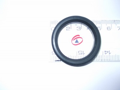

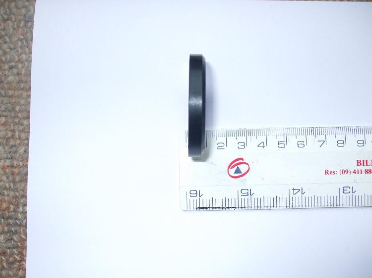

Post by WideOpenThrottle » Sat Apr 14, 2012 9:02 am
Anyone knows where this goes?...not mentioned in my book!
Post by WideOpenThrottle » Sat Apr 14, 2012 9:04 am
Damm pics wont load!!!!!
Will try again later.
Post by WideOpenThrottle » Sat Apr 14, 2012 5:46 pm
Got it to work!
Asked the guys at BNT & they didnt know either!
2low2c
Posts: 153
Location: north shore
Post by 2low2c » Sat Apr 14, 2012 5:59 pm
looks like it could be the c a s seal
Post by Born_disturbed » Sat Apr 14, 2012 6:00 pm
Looks like a cam seal maybe? goes on the cam behind the cam gear, or for the cas at the other end?
Post by WideOpenThrottle » Sat Apr 14, 2012 7:36 pm
Done both the cam seals from the pack and the cas seal in the past [from Mazda] has always been an o-ring rather than an un-even sided one like this[maybe i should look at that cas-seal again as it might well be it]?
last_resort14
Posts: 252
Post by last_resort14 » Sun Apr 15, 2012 11:25 am
It's not something silly like the oil filler cap seal?
Post by WideOpenThrottle » Sun Apr 15, 2012 7:03 pm
Well,its not the cas-seal & while it is close to the filler-cap seal it doesn't appear to be that![the seal in the cap doesn't want to come out anyway]!
Might just have to ignore it!!
Post by SLYDIT » Mon Apr 16, 2012 8:28 pm
thermostat housing to head o ring??
was the head kit for an mx5 or a generic b6 one that fits familia etc?
Post by WideOpenThrottle » Tue Apr 17, 2012 8:22 am
Thermostat o-ring is way smaller & this head set is mx5 specific [B6-ZE 1597cc 1989 on].
Just rang Permaseal gaskets & they seem to indicate its the filler-cap seal!
Top of the class to Last Resort! :D
