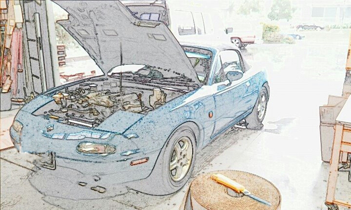

Post by Blubee » Fri Mar 23, 2012 1:38 pm
Okay, I'm back - sorry for the departure from my own question forum..Had the belts replaced. apparently there is "play" I'm the passenger side fan ie it moves a bit. However a new fan is gonna cost around $600.... The other school of thought ie wkmates opinion is that it could be a bearing in the air con...
... live the life you love so you can love the life you live ...
