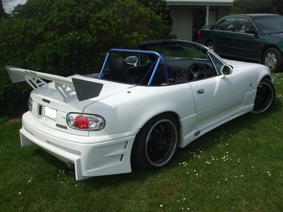

Post by Growler » Wed Dec 14, 2011 8:47 pm
The hardtop is slightly lower than the soft top.

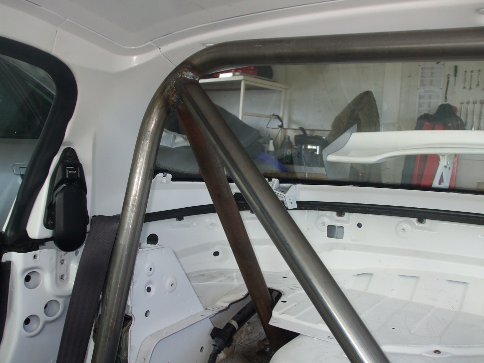

Post by WideOpenThrottle » Thu Dec 15, 2011 11:01 am
[quote="SimJen"]it fits over the softtop no problem, have no idea about the hard top as I don't have one![/quote
As a rough indication my roll bar is approx 150 above the standard seat headrest top & approx 980 above the floor carpet behind the seat & my hardtop fits

Post by punkoutnz » Sun Dec 18, 2011 6:39 pm
Not sure if the hard top will clear that, it sits pretty high but are you keen to give it a shot some time soon?
