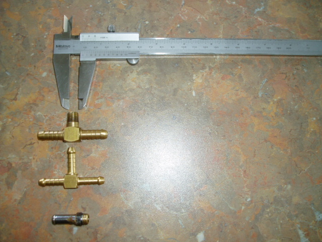

I got some fittings!
will take a wee pic or tae see below,
the one closest to the calipers is the same diameter as the actual fitting!
Its an npt thread and its yours for $10

Well, so far Wellington hasn't got any. I'm so sick of bewildered salespeople and stores with no stock. So much for getting my car running today.
Has anyone actually tried this repair before? I'd be interested to know the best way to add a 'T' join in the system, since I actually have to connect two hoses.

Habanero666 wrote:I got some fittings!
I just saw your post. They look like they might be useful. Thanks for posting.
I'll send you a PM.
