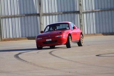

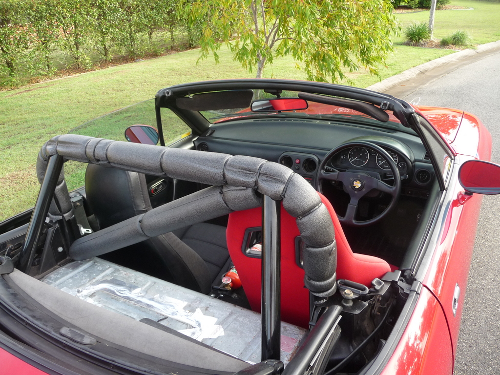

below is an aussie "brown Davis" bar which is motorsport approved in australia BUT NOT in NZ as the muppets at MSNZ are not flexible at all when it comes to actually being able to get a bar in a car,other than the way they want it.
Oh and one of my car racing in august...(need some sway bars! LOL)
