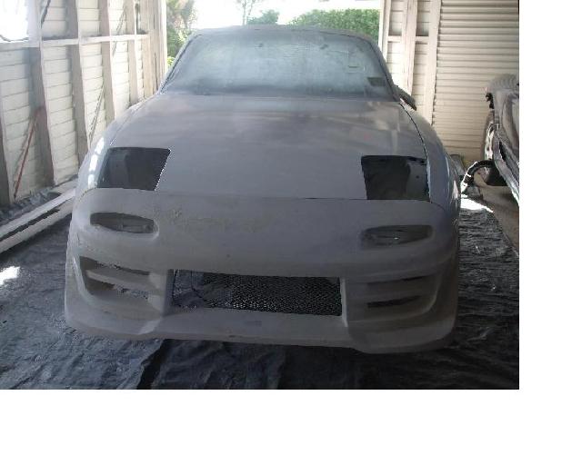

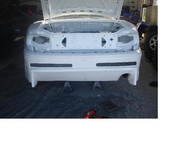

Post by WideOpenThrottle » Fri Apr 17, 2009 7:53 pm
Look what i,ve done!
The rear was easy to fit while i had to grind & rebuild part of the bit by the lights & guard.
The side skirts are too short by about 20mm so going back to the supplier for answers!
Post by WideOpenThrottle » Fri Apr 17, 2009 7:59 pm
er !sorry earlier post meant to say had to grind & rebuild the front kit. Doh!
Post by sprsta » Fri Apr 17, 2009 8:36 pm
dont worry this is nothing new i had to cut my side skirts in half and rebuild them the front bumper never fits to the gards and the rear bumper fits ok(ish)
actually the sideskirts dont fit at all i made mine out of about 8 pieces after i cut them to pieces

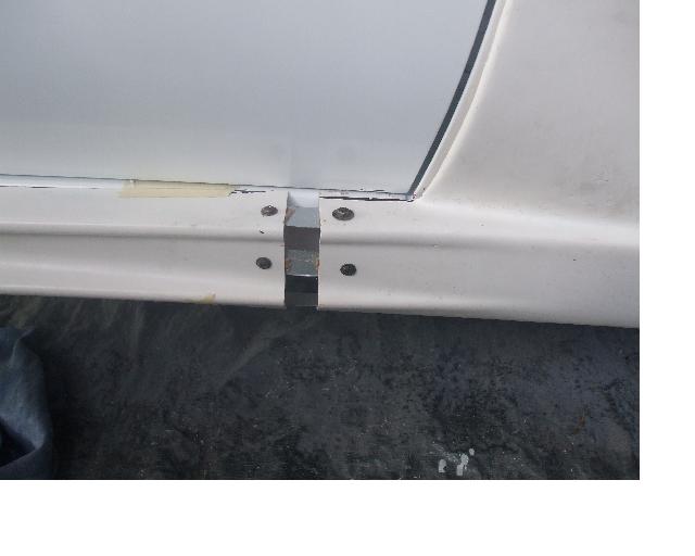

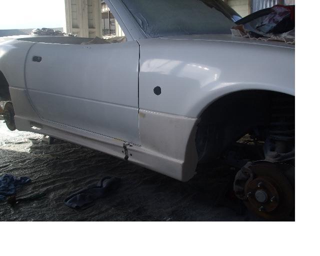

Post by WideOpenThrottle » Thu May 21, 2009 8:13 pm
Side-skirts now cut & temporary glued & screwed in place till hardened then i will be glassing the gap & giving the completed shell a few more coats

Post by sprsta » Thu May 21, 2009 8:34 pm
that is a good fit to be honest i used that stuff you laminate school books with (girlfriends mom is a school teacher) and stuck it to the side of my car then glassed to that it seems to release pretty good i should have taken some pictures.
i suppose was is a diference in price between mine and yours though at $250 for the full kit i was ok with it
i thought it was funny that it came in primer and rubbed down and ready to paint though. i would laugh if someone got them painted and tried to fit them tmemselves
