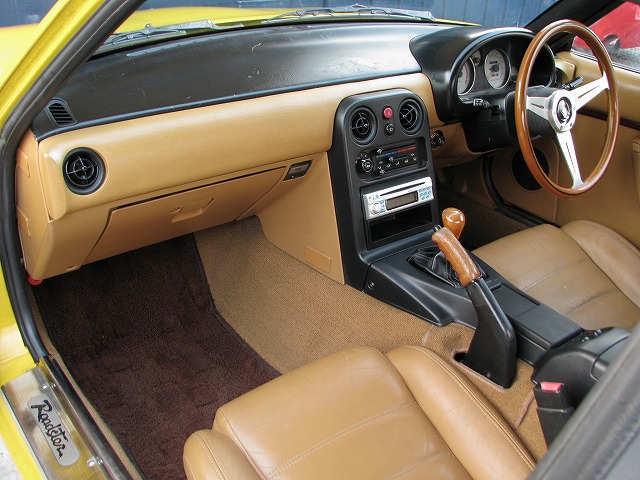

First check the VIN plate under the bonnet for the paint colour code which should be HZ. Anything else will define it as a repaint. The interior should be standard black like most models. Your Tan could've been retro-fitted like our north american friends seem keen on doing.
your interior light problem could be also loose contacts in the sliding switch of the light fittings themselves as we discovered on our Mariner blue.
I notice your guage faces in the instrument cluster are not standard for this model too. A further indicator of a repaint??
