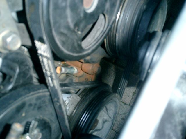

I did have an overheating problem with my MX5 too a few years ago (slow
cooling system leak), and found that there was a slow leak on the elbow
that comes out of the front of the block (pic attached - elbow is just
to the right of the belt writing). There was a bit of corrosion on the
bend, and vibrations caused a small hole. Apparently it is quite a
common issue.
cheers
common issue.
cheers
