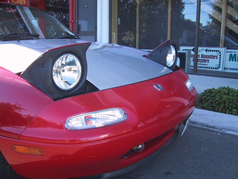

i just replaced my headlights with H4 semi sealed replacements from partmaster. just $72 for the lenses and h4 lamps for the two.
they dont fit quite the same, and will require you to replace the six locating ring screws with longer ones (4mmX20mm) easy job. you can have them changed in half an hour.
pop up lights.
remove black plastic cover 4 screws
remove 3X locating ring screws and bin 'em
unplug lamp.
fit h4 lamp to new lense and plug in to car.
fit ring with 3Xlonger screws
etc etc

+1 on the H4's. Fitted the same to my NA a few months ago.
My daily drive to work is in the dark during the winter. So after a few months of driving in the dark I am still pleased with the result.

Dont try the wagner brand semi selaed lamps from repco. They are to thin and flop around once fitted. I supplied 2 to a customer and then supplied him 2 white box brand ones that i had fitted to my car that fit perfetly. BNT used to sell them but have gone to sealed beams now and no longer sell them. You can then go to an upgrade hella or narva +50 or. +90 bulb to get even better light out of them without any extra heat or current draw.

The standard headlight is a sealed beam (bulb is part of the lamp and not replaceable, replace whole light when blown)
The semi sealed lamp has a replaceable h4 bulb. Some semi sealed lamps include a bulb, but most dont so they need to be purchased also when the semi sealed lamps are purchased.

Unfortunatly not. I have only one left, my usual supplier of them has gone to sealed beams for some unknown reason so i no longer have a supplier for the cheap semi sealed, only the expensiver Narva ones. Steer clear of the Wagner brand ones from Repco, they may fit some models but they dont fit the MX5 without some additional packing to stop them flopping around

thats the same with the cheap ones i got from part master. ($75 for the two with lamps)you have to use longer mounting screws to fit the bigger tabs on the lenses, or snap the tabs off and then pack them out by about 3mm. they certainly arent a bolt in affair and the rubber boots cant be fitted so i am dubious as to how weather proof they will be in the rain... time will tell.
