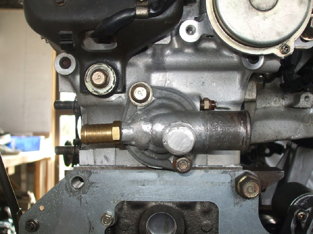

Post by WideOpenThrottle » Tue Apr 01, 2014 1:56 pm
So if its not actually overheating then I guess it will be the gauge temp sensor at the rear of the head that's intermittently faulty?
In the pics it is above the thermostat housing & below the CAS .
