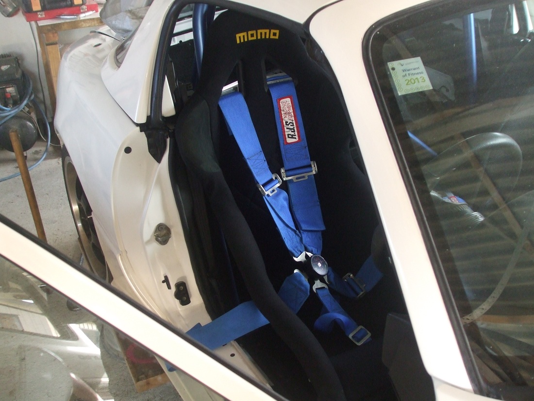

Heres mine..i use both factory and harness [not at the same time].The seat is bolted to factory rails and it hits hits the door card a little just below the window.Other seats may be a better fit but I have no complaints whatsoever!
