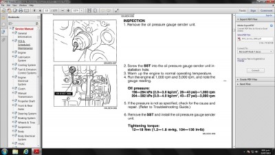

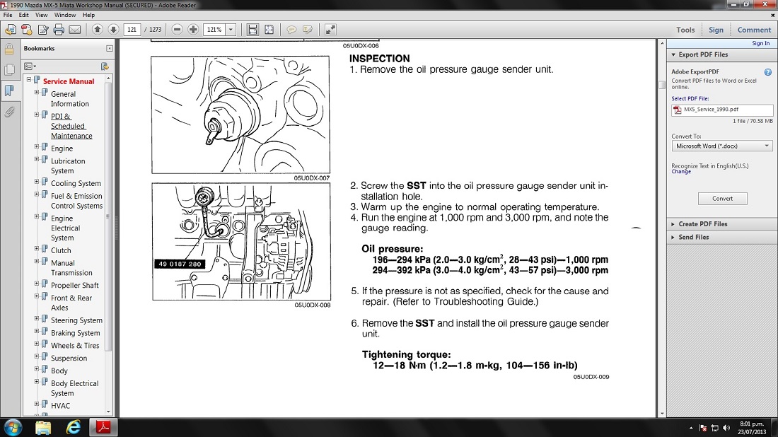

Post by WideOpenThrottle » Tue Jul 23, 2013 8:06 pm
From the workshop manual
