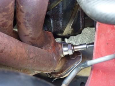

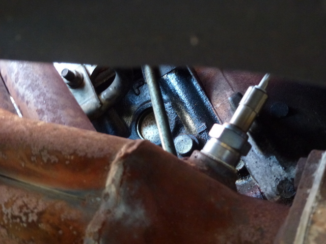

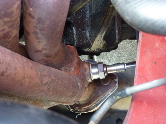

Post by SLYDIT » Sat Aug 31, 2013 9:25 pm
you NEED to fit a HEATED 02 sensor....end of story.
i'd do that before i did anything else.
exactly where is your 02 sensor located? (Picture?).
if the 02 sensor isnt hot enough, it will be lazy in its operation and its signal will die off at idle, but not enough to throw a check engine light.but enough to make the car run way rich
Then id be checking your coolant temp sensor for the ECU.its on the back of the head under the coilpacks (green plug) the wiring loom for this and the coils and the cam sensor has been known to fail at the point where its cable tied to the manifold.

Post by fooesboy » Tue Sep 03, 2013 2:08 pm
OK, been back to BNT, now feel like I've been butt raped for price but now am the proud owner of the universal O2 sensor with 3 wires!
I will go and have it fitted tomorrow.
I've added a couple of photos showing the sensor locatio
