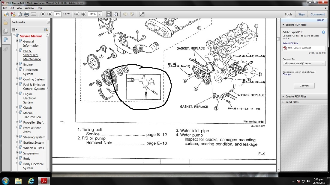

Post by warrior » Wed Jun 26, 2013 4:45 pm
Right after a bit of looking around it is the tube that the 'WATER PUMP INLET PIPE" attaches to , can this be replaced or do I have to buy a new inlet pipe (the whole unit)
And if I have to buy the whole unit does anyone know the best place to buy one from?

Post by warrior » Wed Jun 26, 2013 6:54 pm
Thanks guys, next question. The metal pipe has broken at the 90 degree bend, can I jus get a longer piece of rubber hose and attach it to what is lefty of the pipe? There is plenty of length to attach and secure a new hose and clamp.
I don't see why this wont work?
Post by SLYDIT » Wed Jun 26, 2013 7:02 pm
you can buy a drill bit/BSP tap and fittings for under60 bucks easy and youll be on your way. i wouldnt trust just putting a hose on the unbarbed pipe as it will easily blow off. you can buy the brass BSP fittings in a 90degree fitting also. its what i used to make my dual feed fuel rail mod.
