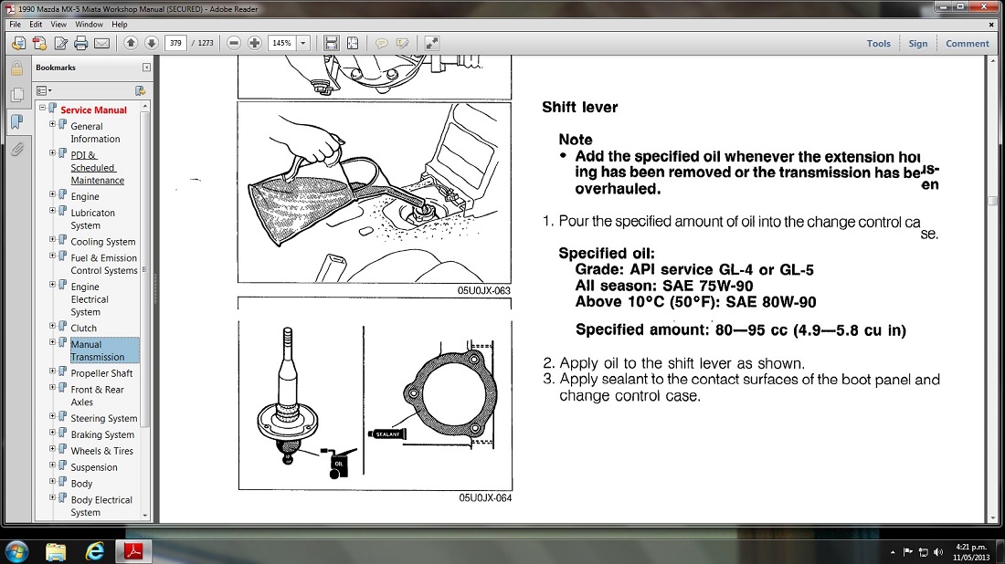

Have removed gear stick as per miata instructions. Can not see any oil in there. Have inserted approx 90 mls of oil. This has filled the round hole where the gear stick locates into.
The miata pictures say to either insert 90cc or till it is full.... My query is if it is only the hole that stick locates into or the complete cavity that the selector mechanism moves inside.
I am unable to determine from the pics on the forumn. If someone has correct reply for this I would be most appreciative.

This is what i know..80-90 mls in the turret and then sealant to the cover.
And fill till its full but no more than 90cc just in case there is some already in there.

Sweeto. Had put 90 mls in but had trouble getting stick back in. I think the plastic collar was slightly binding up instead of locating. It's back together and HEAPS smoother. Amazing what a bourbon can do if something not ready to locate when you want it to.
