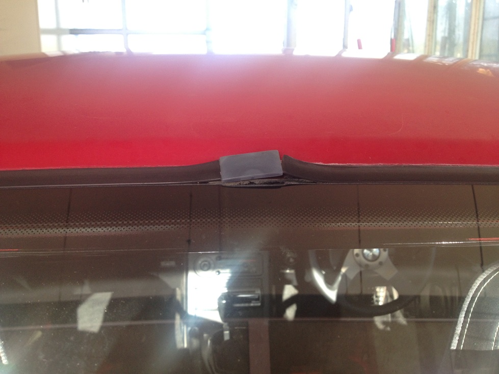

Post by Donovan » Thu Apr 25, 2013 10:20 am
Walked past the car, and notice that the rubber around the rear window on the hardtop is starting to make an escape for it.
Is there a simple fix for it, or can the rubber be replaced, and if so by who?
Post by MrGrey » Thu Apr 25, 2013 11:25 am
the rubber block was missing from mine when I got it so I filled the small gap with windscreen sealant (cost >$20 from bunnings for a tube). Otherwise you could drop into a windscreen repair place like Novas and get them to calk the gap for you.

Post by WideOpenThrottle » Thu Apr 25, 2013 11:41 am
Repaired mine with a hairdryer & black silicon...just hold in place with a thin screwdriver till it cools! [may have to press it home a bit too!
