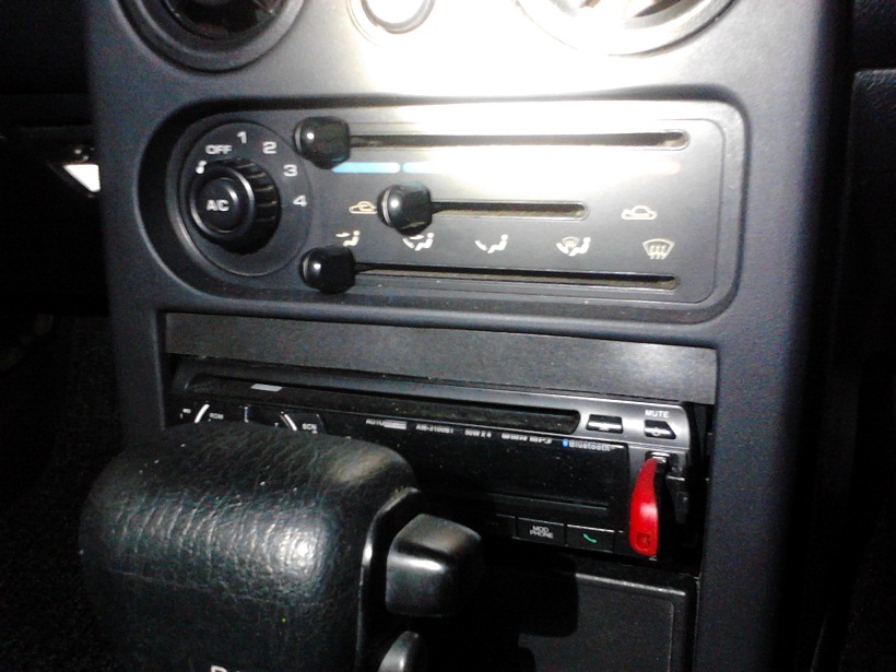

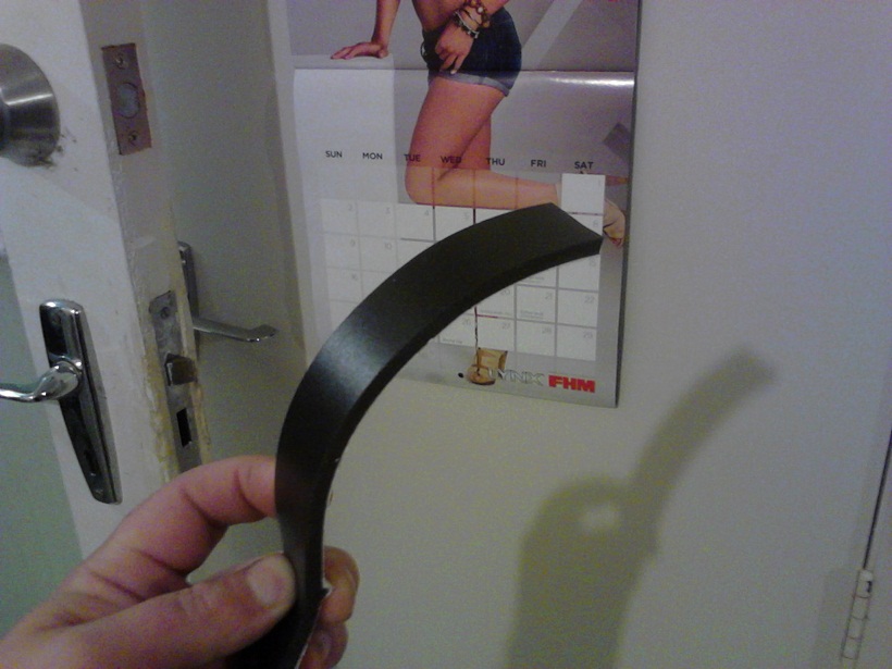

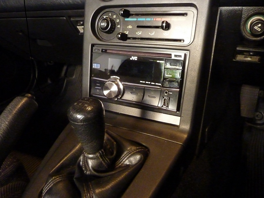

Got the head unit in and working this morning. Nice and simple to do as I just removed the mounting brackets from the old cassette player, screwed them in to the new one and used the wiring harness adapters from Repco to wire it in. Found solution to the small hole at the bottom of the new stero at work on a shelf (black Kappa board). Trimmed a bit to size and fixed it to the rear of the trim panel. Fairly happy with the result. Speakers next!

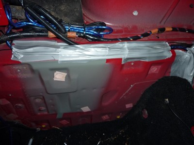

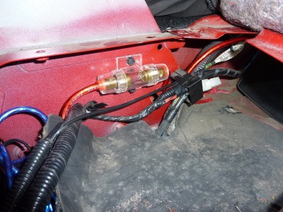

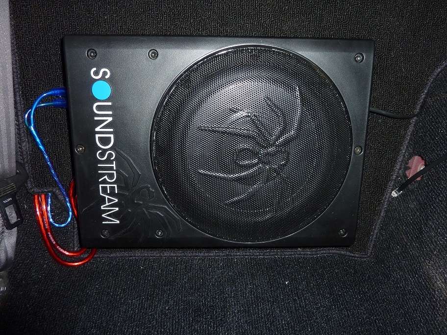

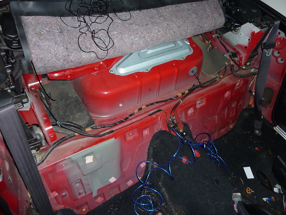

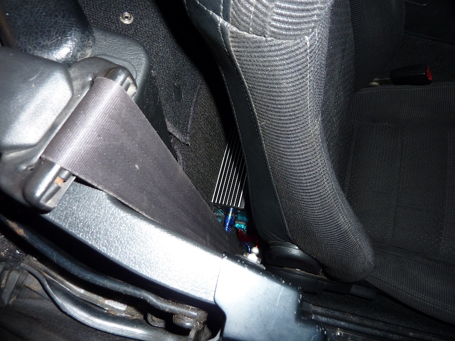

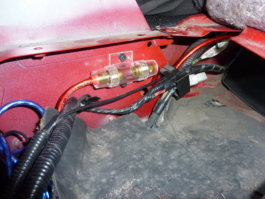

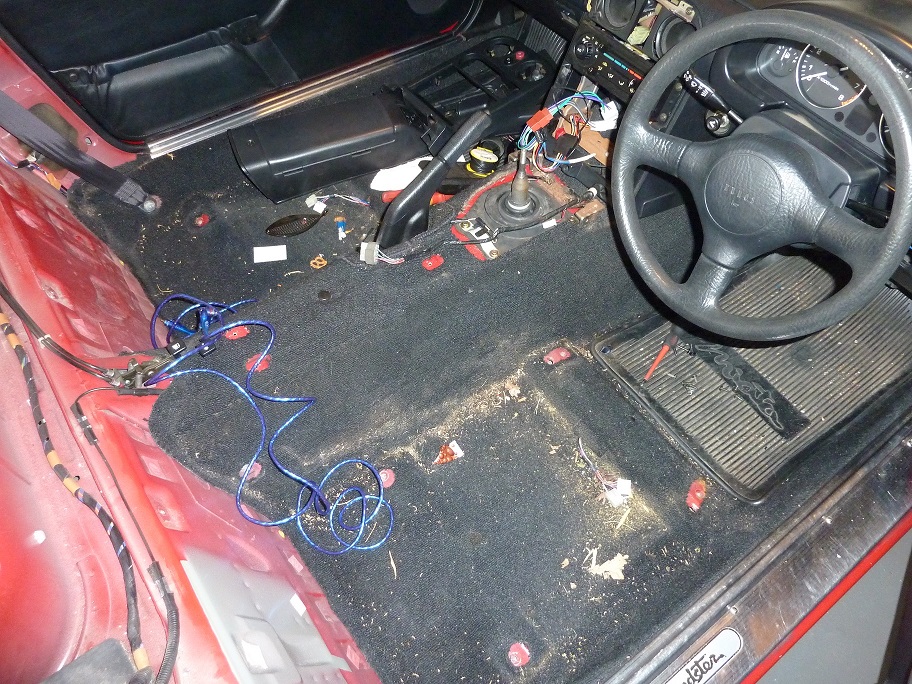

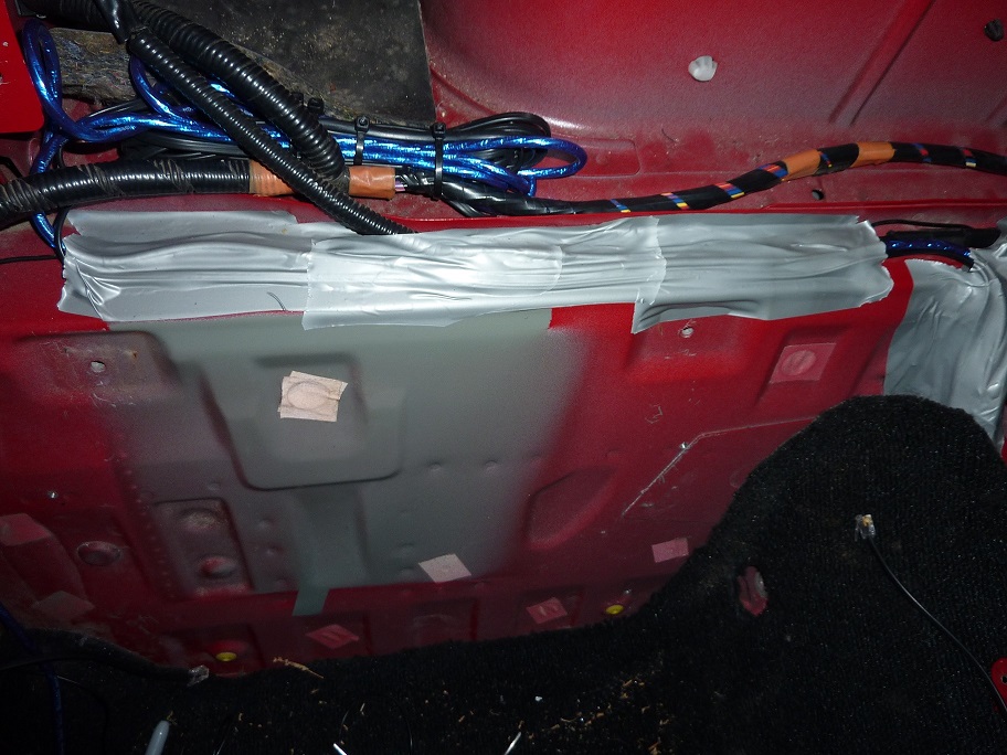

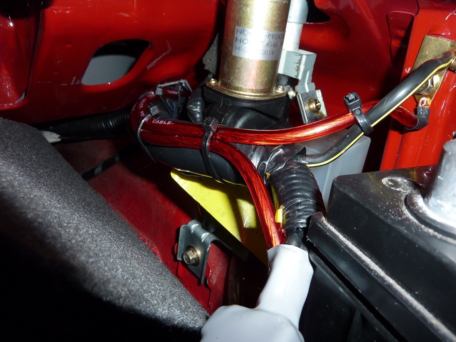

Everything now fitted and working after a fairly intensive day and a half of labour over the weekend. I clicked on a buy it now for $199 for a Fusion underseat sub as recommended by others and went to collect it to be be told that the store selling it did not have any left. They did however give me the option of either waiting for it to come in stock (I did not want to do this having stripped the car and filled up any spare space left in my small garage and within reach of our dog which likes to chew black plastic ! ) or to have a $449 Soundstream equivalent so I took that. Pictures attached of the strip (including the filthy carpets that were all vacuumed when the job was finished before the seats went back in). Happy with the result and I just need to go through the numerous settings on the head unit and tweak the settings on the sub to suit all types of music.

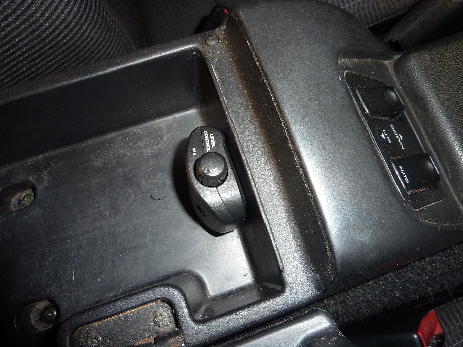

The finished article. Carpets cleaned and the car back in almost one piece !

Post by MrGrey » Tue Apr 30, 2013 9:56 pm
grats on the soundstream, they are nice 8)
once you tune the amp you will be good to go.... but bear in mind, mine took a lot of micro tweaking over 2 weeks to fine tune it to something I liked.
one other thing, that little gain dial is kind of pointless (it would have been better if it was a volume rather than gain) so once its set, it will quite happily sit there and gather dust, so you did a good call by hiding it away.

My only slight concern is that it looks like you may have the fuse mounted some distance from the battery terminal. Even as far away as on the other side of a bulkhead? Given the gauge of the wire, as close to the terminal as possible might have been preferable.
ryanhorton1973
Posts: 31
Joined: Tue Jan 22, 2013 12:58 pm
Post by ryanhorton1973 » Sat May 04, 2013 5:42 pm
The fuse is mounted inside the boot. It is behind where the spare wheel sits. I did not mount it closer to the battery as it may have got knocked / broken when my golf clubs are wedged into the boot. I did resistance checks on both locations and the difference was negligible.
