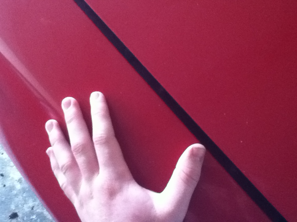

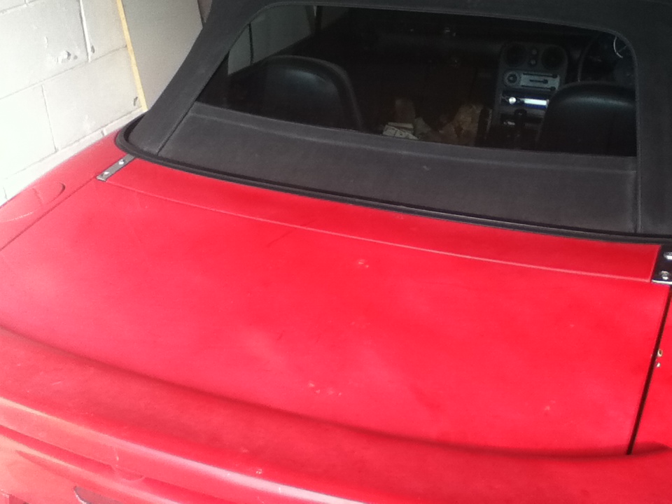

Here's the back of the car. Excuse the dirt, it needs a wash desperately (and a tidy up in the passenger footwell). It has the back end sort of sticking out of the carport so the fading is worse on the back.
The other pic is some of the paint chips relative to the size of my hand, the photo didn't come out well but you can see some white specks
So, what should be the course of action?

:D your paint has oxadised, a good cut and wax will bring it back, red needs a good coat of wax,
malcster
Posts: 118
Post by malcster » Tue Aug 14, 2012 5:24 pm
Yeah red and silver are the 2x worst colours for fading so need extra special care.

Just a heads up. The red cars didn't have a clearcoat on the paint. Its a solid colour paint. Thats why it fades. I use meguires fine cut cleaner. Followed by the polish. Them a carnuba wax.
After that its just a maintenance wax as required.
