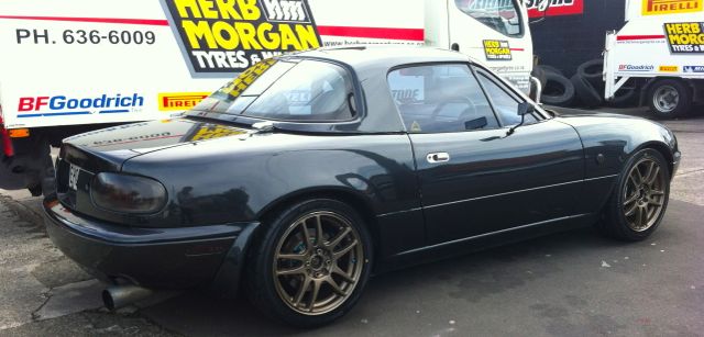

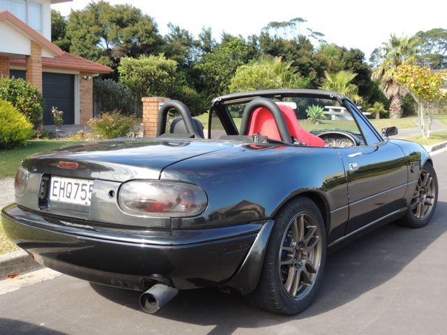

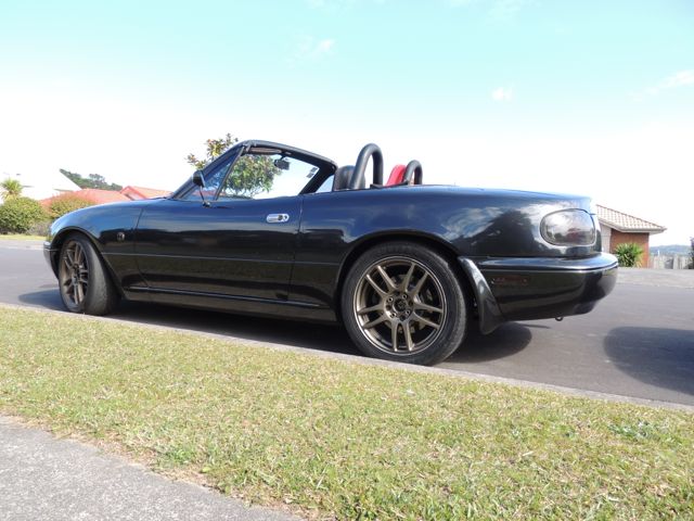

Hello all.
i have had a few years with no MX5 - divorce took care of that...
but now i have just bought a 1990 NA with some nice bits.
she's pretty scruffy, so there will be a lot of work to do - i'm sure ross will do well out of me in the next year!
anyway - here's some pics.
it's my intention to document the process here.
first questions:
1 - anyone know of a suspension shop with experience in height adjustable bilsteins? the shocks are pretty new - but the springs are WAY too hard, need some softer springs and someone to set the car up right.
2 - car has 16" rays lightweight wheels, am planning on a set of 205-45-16
any recommendations? i'm currently thinking T1R toyos or RE002 Bridgestones.
3 - paint is a mess. runs from bad prep and blisters from rust spots. also may have a tiny rust issue at base of windscreen/pillar
anyone recommend a good painter? the paint is a very dark gunmetal - apparently a BMW Z4 colour...
anyway - take a look and comment away, i'll keep this updated.

oh - and that red seat
was the first change.
std driver seat now re-installed.

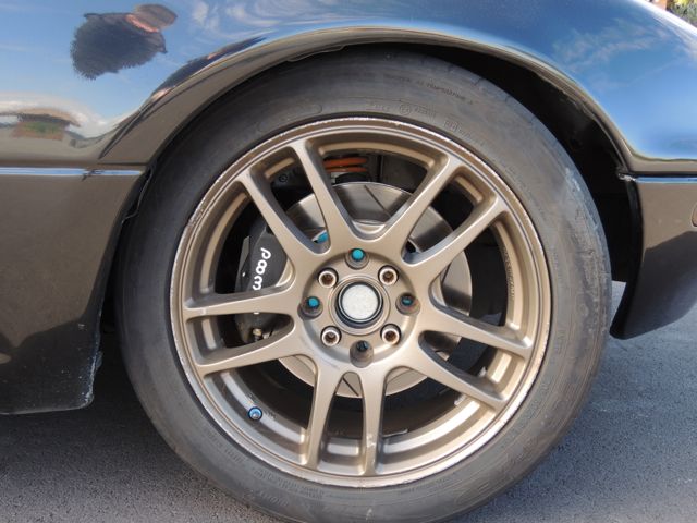

16s
yeah - i didn't choose the wheels of course. i would have rather had 15".
the tyres on it are 205-50-16 - all shagged.
so will get some 205-45-16 and they will be a little smaller in overall diameter.
Of course they add to how "crashy" the suspension is, but i'm going to get some decent tyres - an alignment and drive it a bit and see if i can live with it.

I always thought 16"s were too big as well,Until i got some thru work myself and put them on,A bit twitchy now but i do like the look of them on my own car,205/45/16's are a bit tall for them,throws out the speedo a bit,but you learn to compensate,Does knock off a bit of acceleration,I think when i wear out my tyres i will look for 205/40/16's,A better match to 195/50/15's.
Someone has put some good bits on your car by the looks,Wilwood brakes and slotted rotors,What else have they been busy doing ?

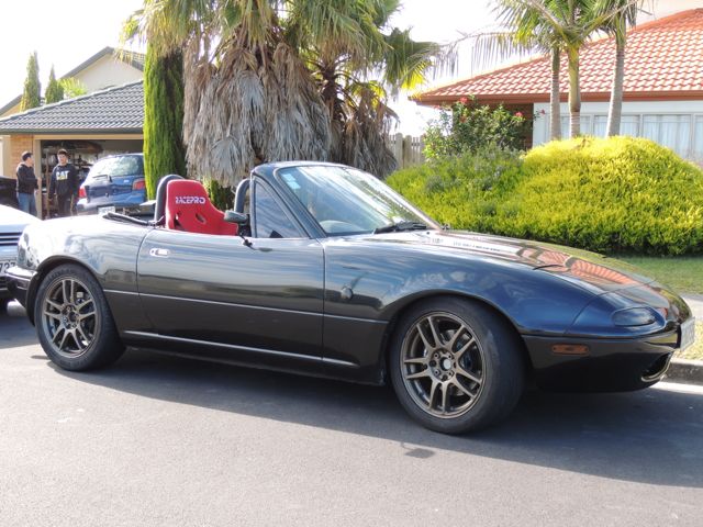

pic of the car with new tyres
got my 205-45-16 RE11 bridgestones todaY....

Update
Well.
Got my RE11s and then took the car to chris at centreline in grey Lynn to take a look at the suspension and give it a wheel alignment.It was impossiblly hard and very jarring and noisy over small bumps.
Chris had it for a day and called me yesterday.
Turns out the previous owner had reduced the ride height so far that the car was sitting on the bump stops at rest.
As in the suspension was wound down so hard that there was zero travel.
Chris said "I'll raise it up and give you some suspension travel"
Prev owner had also installed plastic wheel spacers, possibly to increase the track. They are gone now too....
Needless to say it feels a lot better now.
It needs some new tie rod ends and one of the front arms is bent, but it's driveable now and we'll repair the other bits in the next couple of weeks.
It's getting better.
Lots more to do, but at least I know what it needs!
And I got rid of the awful ricey faux carbon mirrors tonight. Std ones are much better!
Ken
