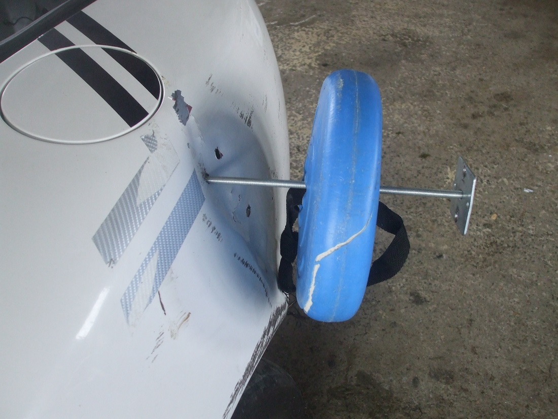

Made a slide hammer to pull my Hamptons dent out then bogged, sanded and painted it! :D

Post by REDBEN » Wed Dec 03, 2014 11:17 pm
Great Job WOT, like brand new :D

Cheers Redben.

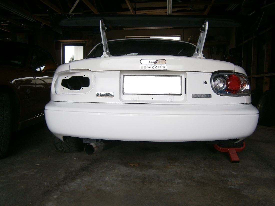

Painted & fitted rear garnish panel and cutaway bumper. Tail-light next!

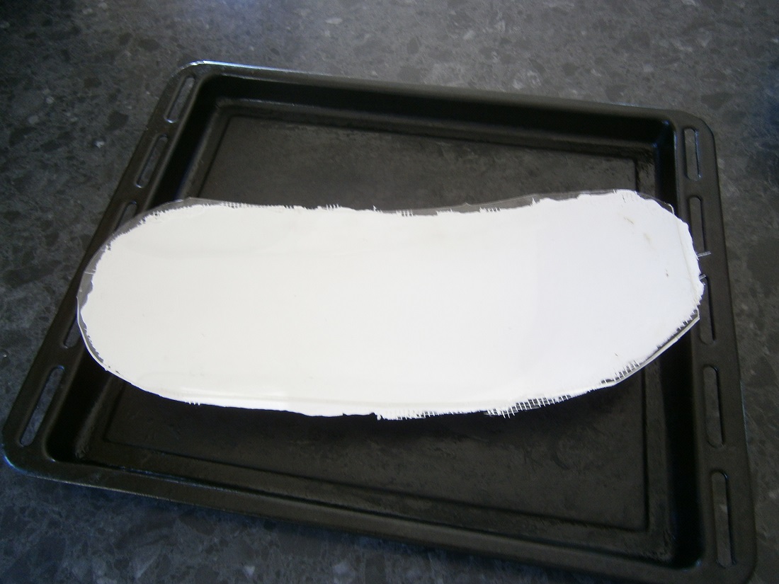

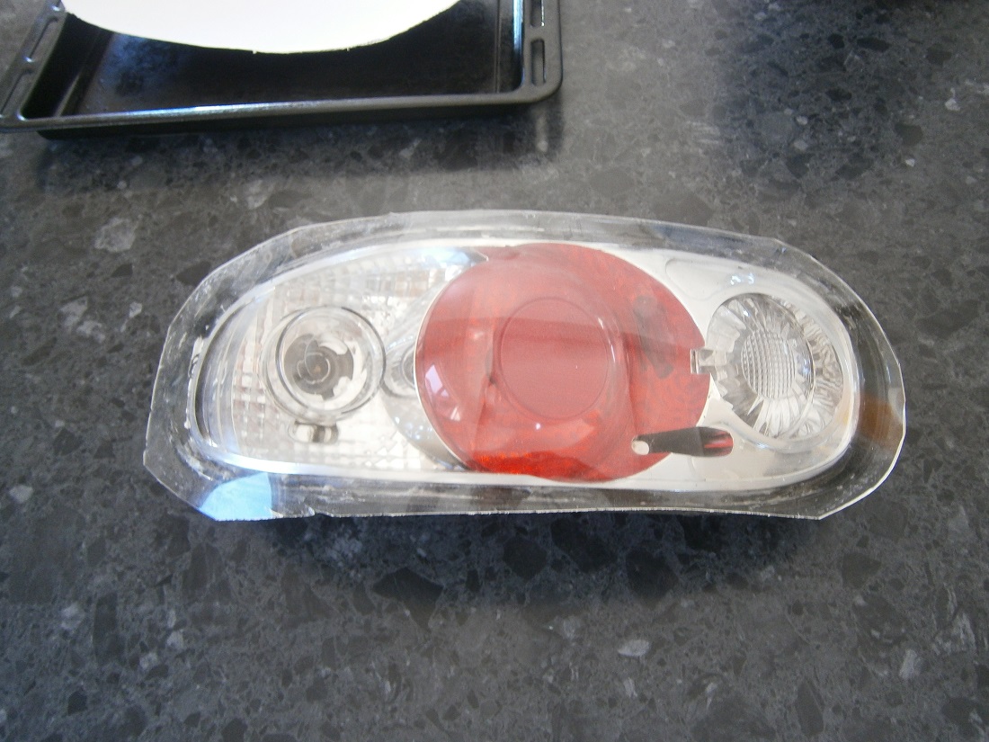

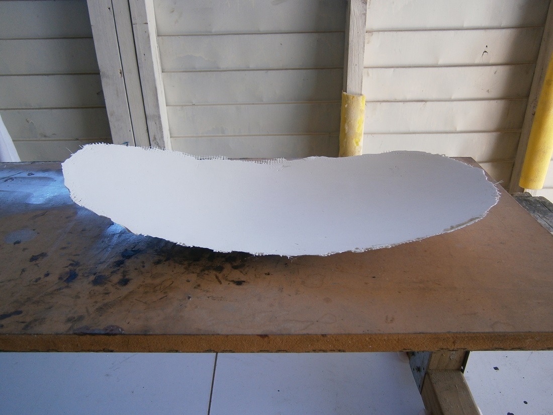

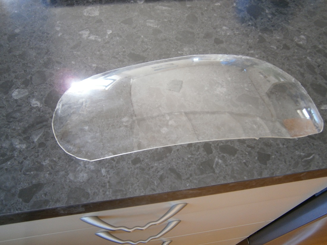

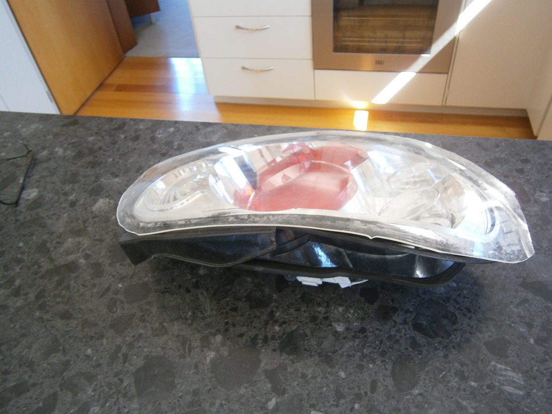

Post by WideOpenThrottle » Tue Jan 06, 2015 5:09 pm
Made a plaster mould of the right-hand tail light...heated up a piece of acrylic in the oven whilst sitting on the mould and viola! a new lense for my left hand tail light! Just needs a bit of trimming and then siliconing on to the unit.
