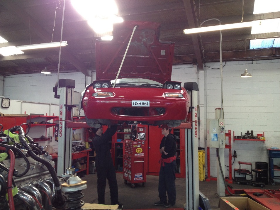

Had a meeting in the Tron today, so thought I would punish myself and drop by the workshop to see what was going on. Well the headers had turned up that morning, after being HPC coated, and were fitted onto the engine block, and the engine and tranny were in the process of getting put back in for the umptenth dozen time, this time hopefully for good.
Apparently Axles were just having the heat treatment today, so they should turn up towards start of the next week. Was even told that I can think about booking in for getting it all dyno tuned. Most likely going to take it to Pro Tune in Manakau, as they are the one that removed the codes from the ECU for ABS, air bags etc. Will cost another $800+GST for the final tune and they would like car for a couple of days. Apparently they know about the build and are keen to get their hands on it. Torque Performance are doing a special at the moment for $750 for a dyno tune, but don't know whether they will cover the setup of my one under this. Will have a chat to them next week, as I am taking the STi in there to get get beefed up a bit, and get rid of the 195km/h limiter on it.

Took my son down the the fielddays on Friday (man, what a mission with the traffic, everyone in AKL at the blinking place, and it was so huge), so thought I would drop in and see what the story was.
Well the story was good, axles turned up, and were in there, so it was driveable. Unfortuantly my 4yr old decided to have a chocking fit just after we got there, and then after 10mins of sorting him out, he decided didn't like the red car and wanted to go back in the blue car, so another 10mins of coaxing him in this one for a quick blat down the road.
I was planning on the first drive of it, videoing it, sticking it up on youtube and just having a link to that with no comments. Well between trying to sort out my son, and just wanting to hope in and take it for a drive, sort of forgot to get the video, sorry.
Exhaust tip on it looks stock, and there is just a single pipe out the back, so at the moment it looks like a stock MX5 with big wheels and a crappy paint job. It is pretty quiet at the idle and be hard to pick up the engine at the lights, and even in a car park you would just think that the engine had just been fiddled with a bit, rather than what is actually lurking under there.
What's it like to drive, well considering I had my son in the car with me, I was being pretty easy on it, but it is effortless in it's acceleration, any gear, any revs, you touch the throttle and it surges forward, no hesitation, no waiting for a turbo to spool up, it just sits it's bum down and goes, which sort of leads to one of the problems that I have with the car at the moment, but more about that later.
It doesn't feel like a wee little hairdressers car anymore, feels a bit more grown up, but at the same time, I couldn't feel the extra weight in it, so will be interesting to get it on the scales and see how much pork it has added on, hopefully it will be under 1100kg.
So, few issues that need to sorted out before it can go in for certification. First one is the ECU, the one that I got with the motor seems to have a bit of a fault with it, and running that one, it only runs on 7 cylinders, so at the moment, it has a loaner run of the mill Holden ECU, rather than the HSV unit. I have brought my one back up to AKL, and will have to get it fixed, otherwise I am going to have to try and find a replacement unit if it can't be fixed.
Second problem is the suspension, seemed pretty soft, compaired to what it was before, and they had to raise the height on it by 20mm, as when you stuck your foot down, the butt squatted down, and hit the bump stops. Since I wasn't thinking about things that the time, I forget to check the damper settings on the suspensions, since the Tein's I have in there have adjustable damper as well, so have fired the workshop to find out whether they are aware that they can adjust the damper, and what it is set to at the moment. Otherwise, I guess it is to a heaver set of springs.
Third problem is heat, even after a short blat, it is obvious that something is going to have to be done for it to handle track days without it cooking itself. I need to find away to get air circulating in the engine bay and venting the hot stuff out. I didn't really want to end up cutting holes in my bonnet for vents, but it is looking that is the way I am going to have to go. I have also read on some of the American posts, that putting a heat shield around the engine mounts is a good idea, as they tend to melt!
Fourth, is the gearbox, I can now see why pretty much all the V8 Holden's are auto's, it is a horrible gearbox. I have driven a lot of cars in my time, and had the not so great pleasure of stirring some horrid gearboxes (old Alfa's come to mind) but this one takes the cake. It is a real effort to try and shift gears, it doesn't like to be hurried, and it is a bit of russian roulette what you are going to get. I thought that since the had the T56 in the Falcon, Holden, Viper, Corvette, Camaro, Mustangs and even some Austin Martin's that it wouldn't be that bad (I know they are different flavours of the same box) but it is. Doesn't help that my one came out of a race car and has got a short shit kit on it, so it has just accentuated the problems of it. This is going to take a bit of getting used to, and hopefully don't lunch the engine while learning it.
So there you go, the journey is almost at the end (or more likely just half way thru I am guessing). Getting that ECU sorted out if my first priority, the rest of the stuff I can just fiddle my way thru.
