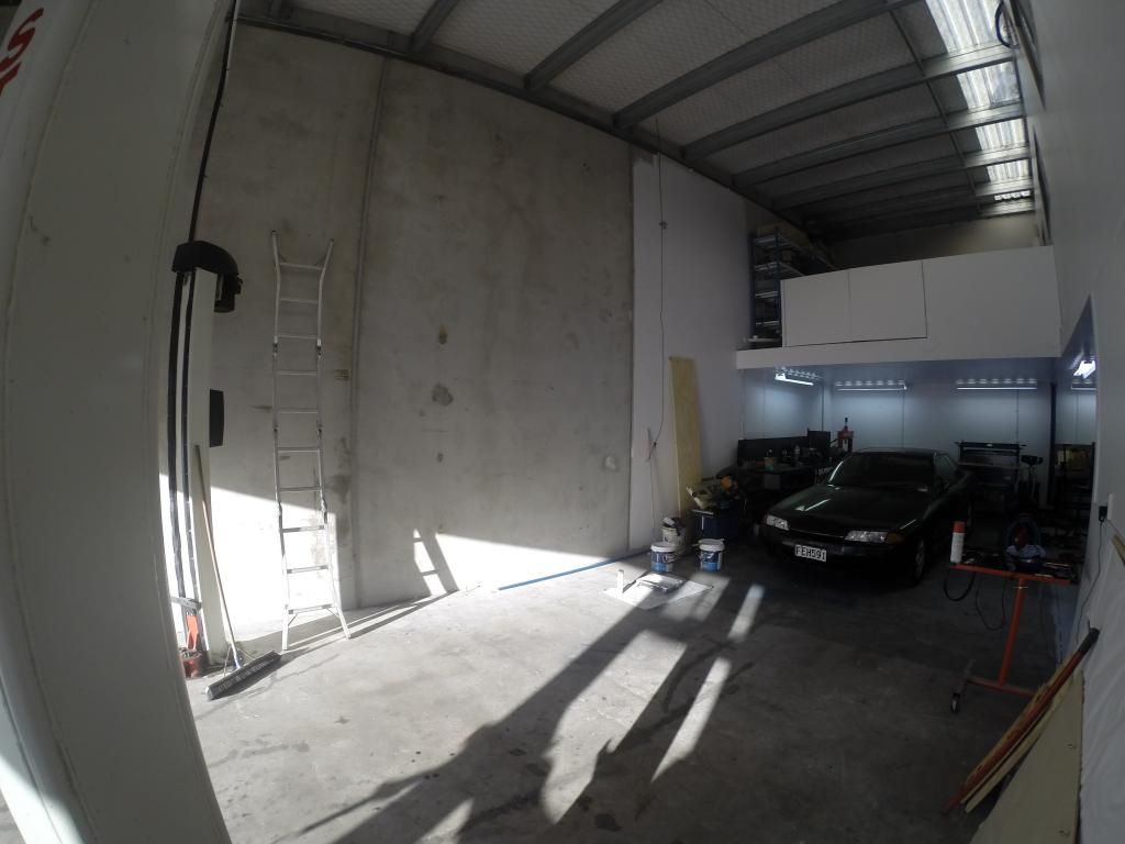

Since i don't wanna start a .. what did you do in your shop today thread..
i'll just ad to here..
Shitty before and afters..
Going to hire some scaffolding to do the top then the walls done
Then machine sand the floor so it's perfect and smooth and done!
another side I never take pictures of.
Post by Angreal » Wed Jun 11, 2014 9:24 pm
I recognise that place. That hoist doesn't fit under my car :wink:

Fresh paint looks smart..... A cheaper option to hiring scaffold is to get an extendable pole. You can then stand on the ground to paint. I use one from a house washing set. Was only $20 and made of aluminium so fairly robust. :idea:

That's done with the shorter pole..
It's pretty high, and i think i'd lose pressure on the wall and the paint wont be as thick..

I have a couple of robust extension ladders you can borrow to elevate you further up wall if interested. They will reach rhe top of that roof no probs. I understand that a scaffold is more stable than a ladder but also comes at a hireage fee. No pressure. Your call. :)
Post by GRUVBB » Thu Jun 12, 2014 6:12 pm
Another option is to put that piece of plywood on a roofrack on top of a van and work from there.... Keep the door shut so OSH cant see in though.

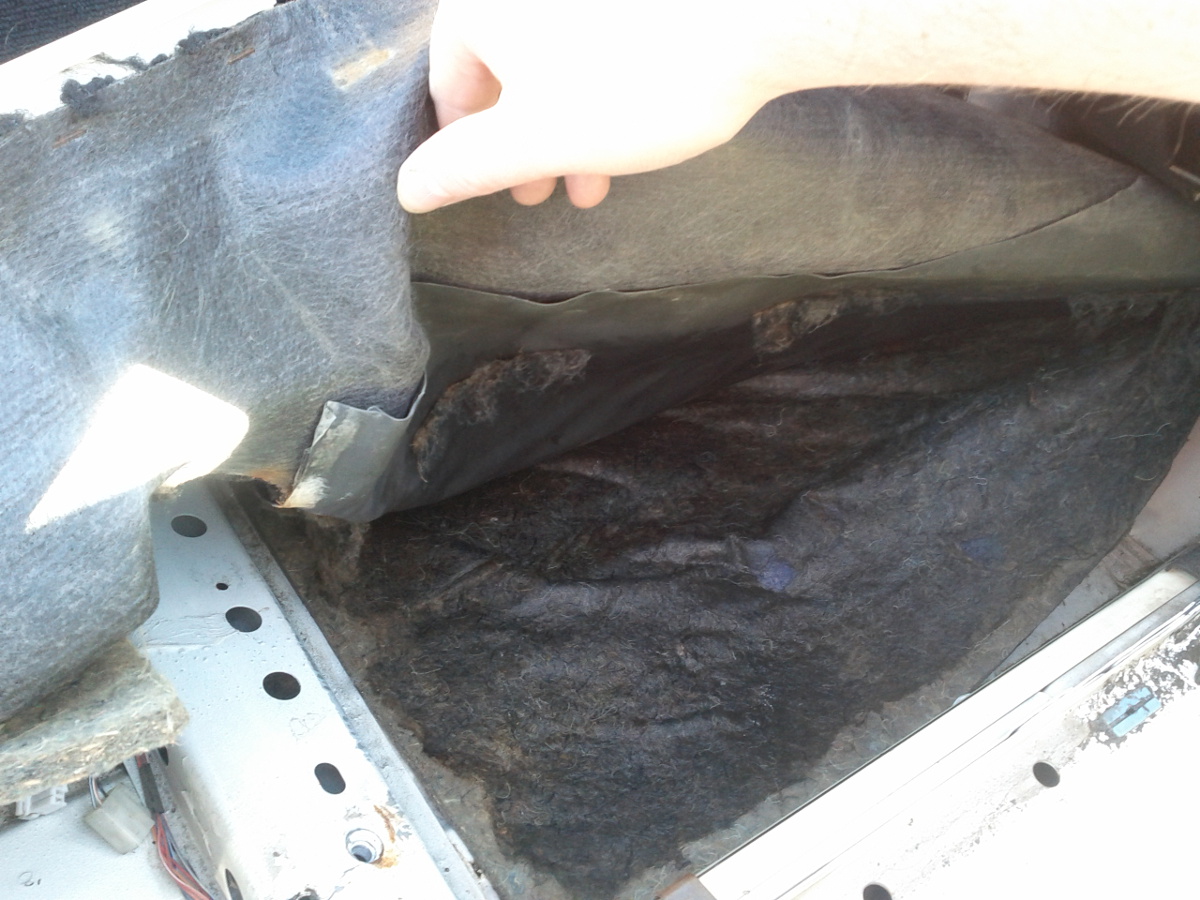

Today I pulled the seat out and pulled the carpet back to discover just how bad my car leaked over the last couple of days.
.. shit, worse than expected

Thanks GRUVBB, I'm ok with the scaffold, feels safer XD And its cheap and easy.. no up and down to paint the roller.
Will be done this weekend I hope.
Post by 4A-GE » Fri Jun 13, 2014 3:31 pm
Ooh. More sound deadening for me to tear out. :D

Hey Marcellarius... i used to have a duck pond like that but it was around my ECU!!! It was a stuffed rain rail to allow that volume in. Check your boot carpets as well. If it is a split rain rail water will ingress through different places depending on where it is compromised. 100 mile an hour tape is good for fixing a split rain rail..... Been There Done That if you want any pointers. :idea:
Post by marcellarius » Fri Jun 13, 2014 4:48 pm
Under the seat was surprisingly dry, as was the passenger side (yay, no wet ECU) so I'm thinking it was either the window weather seals (they fill up with water when it rains) or an issue with corrosion damage around windscreen/seam above door hinge (which has gotten worse faster than I've gotten money to fix it)

There is a side join in the fat weather seal that will drip onto the seat. When you fold the top you'll see what I mean. Give the seals a bit of a tweak night stop it. But dont hold your breath
Post by GRUVBB » Fri Jun 13, 2014 5:01 pm
Sounds like your on to it. Under my seats was dry also but once replaced rain rail with a freshened one the leaks stopped..... Could be worse.... Could be your wifes car in which case you would have to take a loan to get it fixed LAST WEEK!
