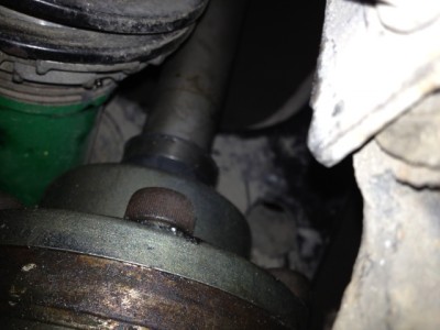

Well, have managed to know one of the things off my list, and it was the one I was was dreading the most. As those following this post, will know that my CV boots were pressed up against the shock body, and wearing thru, even though the shock body was pushed back by modifying the A Arms, and sticking washers in there to space them back.
My initial thought were that I was going to have to redo the whole shebang with RX7 CV's (which should have been use in the first place) or getting something from the US. Anyway, thought I would wonder down and see ADL and see if they had and super small CV boots that fit a Holden, and what do you know, they did, something with an internal boot. So $160 later and I have boots that are literally miles away from the shock body, so in the end if the installers got there, there would have been no to modify the A Arms (god knows how many thousands that got me). See the picks below, and you'll see the gab in place.

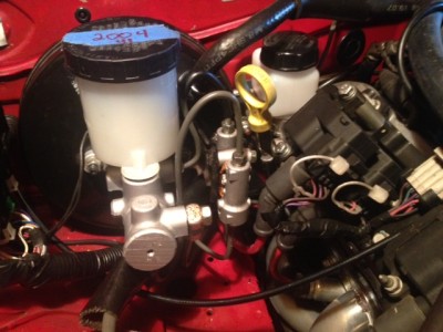

So still continuing on my theme of never getting past the brakes, replaced the rear 1.6 calipers with the NB2.5 sport calipers, so back to 280mm calipers again. Hopefully don't destroy this set. Ended up that I managed to get a replacement bracket for $100 from Mazda and re-used my original sport brakes that I wrecked on the track before, so have a spare set now, for the just in case moment.
Also put the larger BMC from the NB2.5 sport into the car, man that was a mission. People look under my bonnet and are amazed at how the engine fitted in there, it ain't so amazing when you go to replace something, there just ain't any room. Original plan was to use my NA booster (which has a lower assistance ratio) and the larger BMC, but they aren't compatible, well not with out some cutting and drilling, so put the NB booster in as well. The BMC has it's outlets for the brake hoses on the other side from the smaller unit, so 2LOW2C made me up a new set of hard lines to run from the BMC to the proportioning valve, along with a different mounting bracket, as they are in completely a different place as well.
Put it all back together, put brake fluid in to bleed the brakes, and then found that the front hose, even though is screwed in tightly is as loose as a $10 K'Rd hooker (so I have been told), pulled that apart, shove another copper washer in there, nice and tight now as a nun (modern day nun, not Elizabethan nun, sans $10 hooker) or so I thought. Went to bleed the brakes, no line pressure, no fluid flowing thru, lots of swearing and cursing, and generally throwing toys out of the cot. Decided to chuck on a 3rd copper washer, and all good, apart from one minor issue that I didn't tighten up the nut on the line in the hardest place to get to, infact the only way to really get any leverage is to disconnect all the other brake lines, so more swearing. Managed to do it as tight as I could with what I could get in there, not perfect, but will do for the moment till something else is worked out.
Upshot of all that, a brake pedal that has about half the travel of the old one, just need to think about putting your foot on the pedal and can feel the pads starting to grab. Will be interesting using this on the track.
Also got a set of Oxygen sensor's put in, so that should help it sort out running rich all the time.

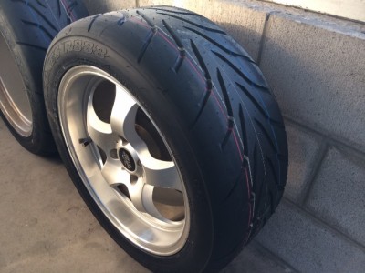

new wheels fitted to the car, had to do some modifications to the guards with the help of REDBEN, but in the process we learnt why people use a baseball bat rather than just a piece of pipe. A piece of pipe will rip shit out of your inner guard.
After a bit of rolling with the pipe, I later took to them with a large knockometer and pulled them out another 10mm, and glad to say after that effort that I can rest assured there is no bog in the guards, there is also no bugger all paint as well
