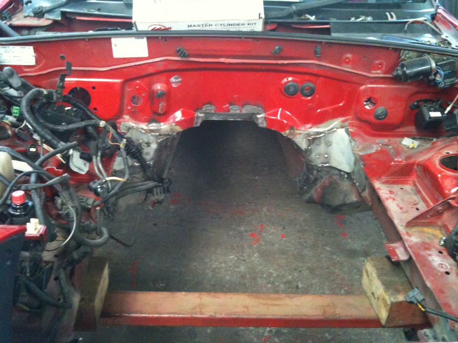

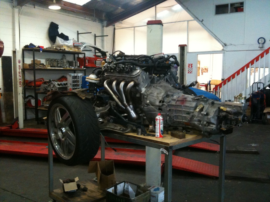

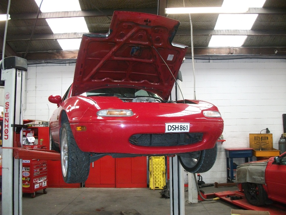

Car ready to go under the knife

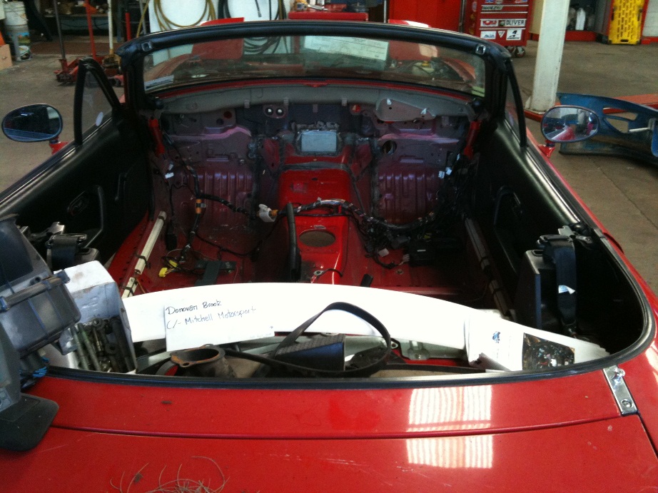

Post by Donovan » Thu Apr 14, 2011 10:35 pm
Now, what's missing here?

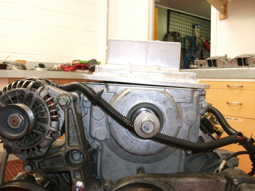

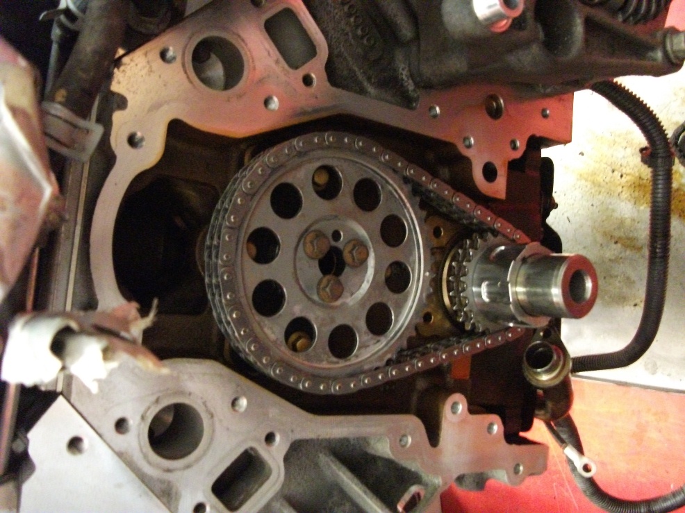

Post by Donovan » Thu Apr 14, 2011 11:33 pm
Double up on the timing chain, for double the fun, hopefully a bit safer for the big revs.

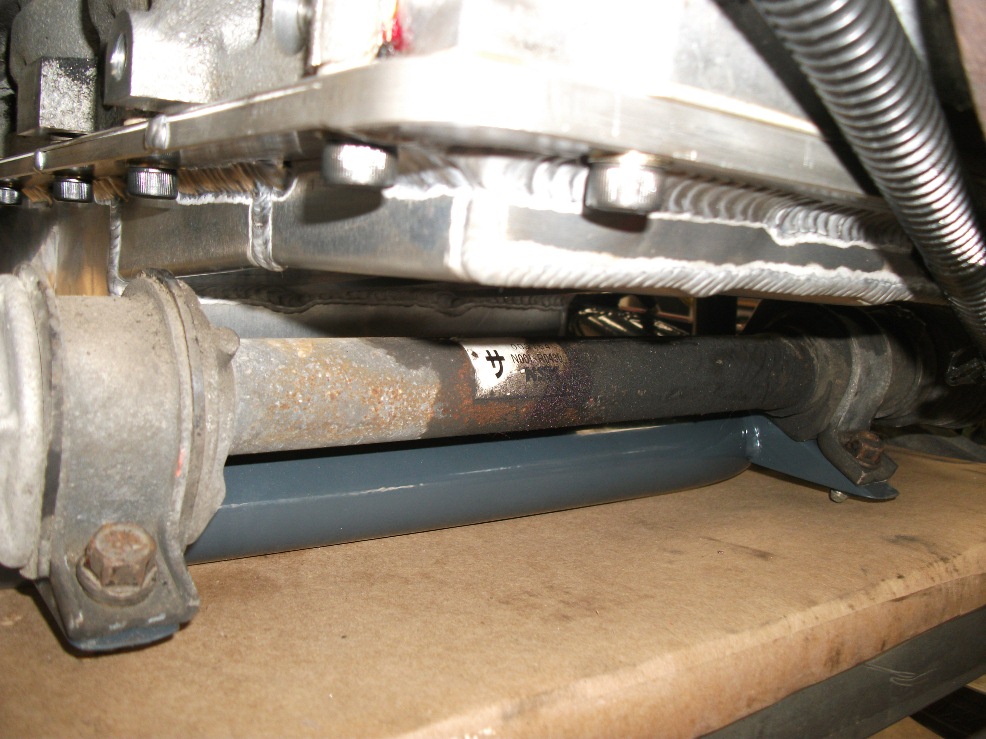

All parts ready and waiting to go in, so time to start cracking into it. First thing to go on is the custom made oil pan. And the first thing not to fit is the custom oil pan (insert lots of swear words here). Turns out the oil pan is too short, and hitting up against the oil pickup on the bottom of the block. We pretty much know that the Corvette and the Holden use the same block, so there shouldn't be any differences there, so can only assume that the pan has been made up incorrectly.
Lots of emails back and forth to Flyin Miata with photos and measurements trying to figure it out.
You can see on the sump marks photo, where the pickup is butting up against the oil pan, making it impossible to fit.
Also from the Room for Africa photo, there is a bit of room there, so no sure why it was made so shallow.

Post by Donovan » Fri Apr 15, 2011 9:46 pm
15th April
Current suggestion is to bend the oil pickup tube so it is no longer touching, hmmm. Chances of starving the engine of oil?

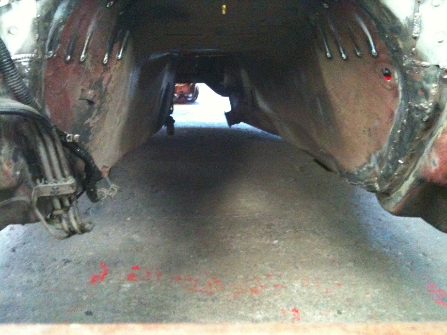

Transmission tunnel has been widen by 2" each side to fit the Tremac, crikey that's a bit of metal bending.

You could machine up 10mm (Or whatever you need) aluminium spacer to fit between the sump and the block. If you dowel it to the sump it shouldn't move.
Post by Donovan » Mon Apr 18, 2011 8:26 pm
Yeah, had thought about that, but just worried that it potentially just gives another point for oil to make it's escape. Going to make a new pickup tube that is slightly shorter, so hopefully will take care of that.

Post by brownie » Mon Apr 18, 2011 8:49 pm
go to a steel sump??,Or even borrow one to confirm suspicions
Post by Donovan » Wed Apr 20, 2011 9:23 pm
brownie wrote:go to a steel sump??,Or even borrow one to confirm suspicions
Pulled a steel one of the engine, plus the standard one doesn't fit, as it is in the way of the front cross member. Plus weight is a concern.
Post by brownie » Wed Apr 20, 2011 10:27 pm
They aren't that much heavier,At least they are easier to modify.
Had a similar problem with a 383 with alloy heads Chev motor i crew on for Speedway,We got the pick up altered,problem solved and no worries so far,pulls 6000 rpm all day long going L/H around the track .just keep a good quality oil in it,as i'm sure you will. :D
Post by Donovan » Fri Apr 29, 2011 1:12 pm
Tracked a guy down in Australia that has done the same conversion and picked his brains for some of the gotcha's with the engine (damn, should have asked him what diff he was running)
Anyway, he had the same sump as me from FM, turns out his one fitted like a glove. So we are going to modify the pickup tube so it fits, FM have agreed to cover the cost of the fabrication.

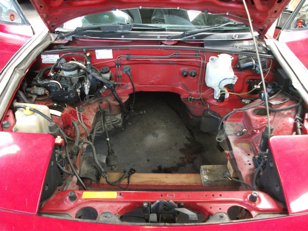

Other than that, there are a lot of parts lying around the workshop and a very bare chassis sitting on the hoist.

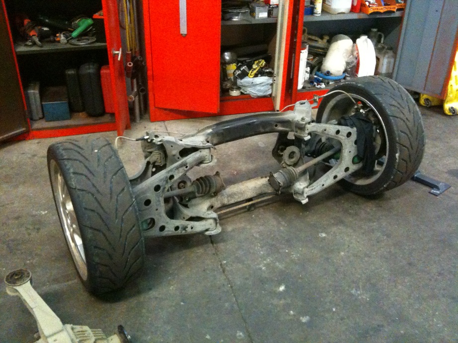

Could this be the fastest two wheeler around
Post by Donovan » Wed Jun 01, 2011 9:28 pm

And here is what is called extreme weight saving

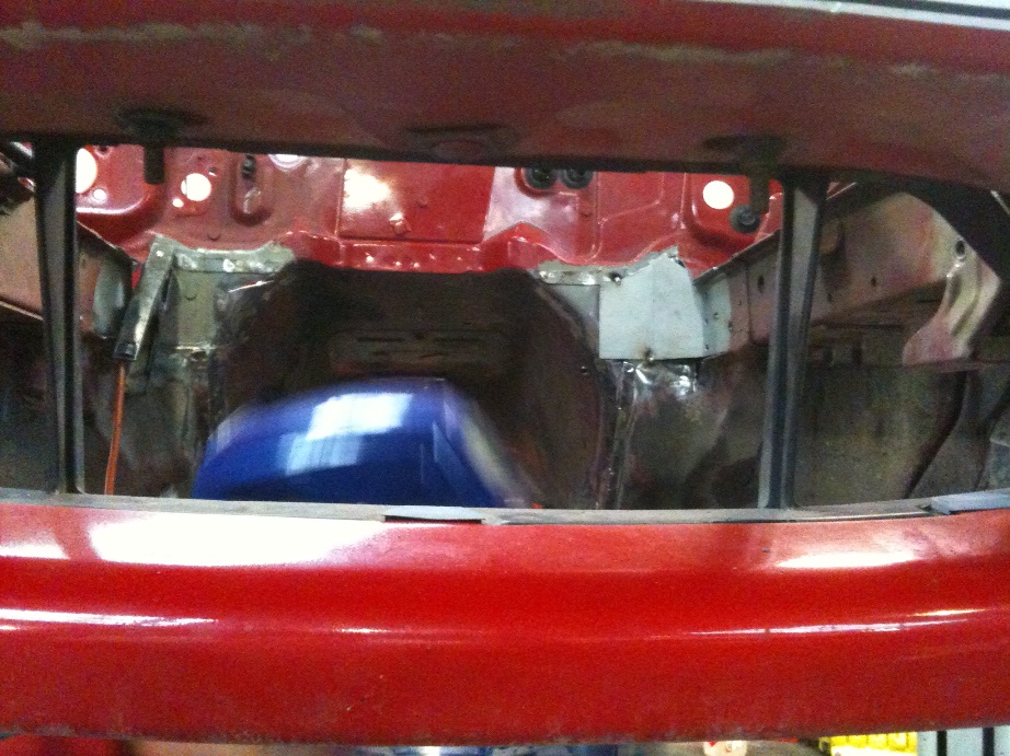

Post by Donovan » Wed Jun 01, 2011 9:31 pm
But I might have gone a bit over board with the weight saving on this one. Was supposed to be a shot looking in via the front air dam all the way out the back, but Barry got his fat head in the way with the welding mask on.
For those of you with the keener eye, you will have noticed that the transmission tunnel has been persuaded to move out a few inches by having the crap smacked out of it.

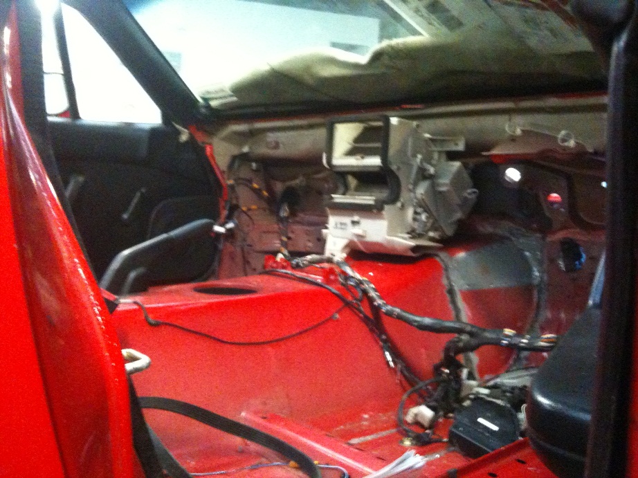

The transmission tunnel has been finished being widened, and is pretty much ready for painting.

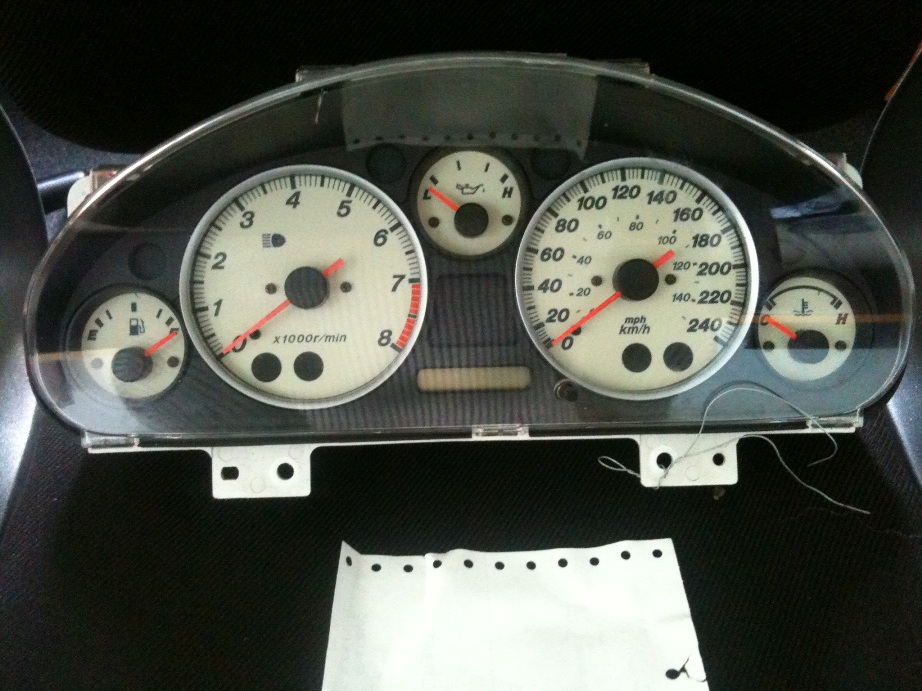

For those of you that have noticed some of my posts, you will know that I have given up the idea of trying to get the NA dial cluster working with Tremac gearbox, and have foolishly decided to put an NB in there and sort out the wiring. Well I got a jap 180kph cluster from 2low2c with plugs for the loom, but really have a hankering for a 240kph (if you can do it, why not show it) so have been looking around for one. Eventually located one....wait for it....in Canada, bonus is it is a white faced one.
So bought it, shipped it back here, and now I just hope the plugs are the same between the two, otherwise I am in shit creek.
