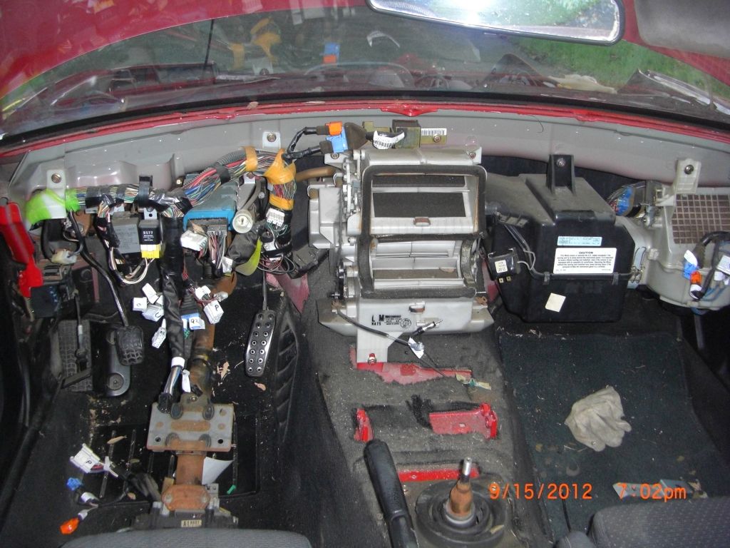

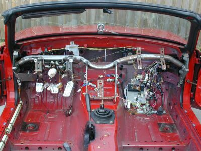

Post by Keith Jones » Tue Aug 16, 2016 3:47 pm
The main cross brace that supports the dash is still there. It's only relatively light gauge tubing and doesn't weigh much. The weight is in the parts behind the dash - heater unit, aircon etc. The brace also supports the steering column, so if it's taken out a new column support is required.
