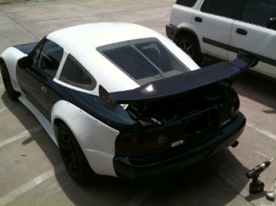

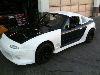

I would suggest this as it will save you a lot of time and hassle (obviously there is a price to pay for not building it yourself !)
http://shop.autokonexion.com/product.sc ... egoryId=24

I do wish the fastback had a more functional boot tbh. I believe you have to slide the back piece off before you can open the boot

1. The Fastback is not permanent. It is like OEM hardtop and it is removable.
2. Anything that will fit inside the soft top and OEM hardtop will fit inside our fastback, and that answers the question on what roll cage will fit on our fastback.
3. No customazation needed to install the fastback.
4. The trunk is a pull-out trunk, and not hinged for racing purposes. The trunk are fully usable, we were able to fit the stock tires with some more stuff inside and close it.
5. The polycarbonate windows that will come with your fastback is usually with tint, but sometimes the manufacturer runs out of the tinted one’s, so it is possible that we may send you the clear one’s unless you specifically requested with tint upon check-out.
We do not charge extra for tinted once, tint varies from light to dark tint, again we will send you what is available in the Market the time you order the product.
6. The bottom part of the fastback is covered and not bare. Unless … #7
7. If you are looking for lighter fastback, you can get the skin only version. We will remove the bracing to reduce weight, therefore the bottom part (where you can see from the inside of the car) will show the weave of the fiberglass.
We strongly advise (a must) for our customer to use a roll cage. The top must be pinned to the cage itself is a must!
8. The new fastback consist of the actual top and a new trunk to complete the shape of the fastback. It will come in white gelcoat and just like any other fiberglass needs prepping, sanding before painting. This process will be expensive.
9. You have to use most OEM latches or we higly recommend to use Spec Miata bracket.
10. You also need to get your own weather strip for the windows from the dealer,or if you want to save money, the soft top weather strip will also work. All the other seals are already on the car itself.
11. The windows can also be water proof by,using window weld silicone from any automotive stores like Pepboys, Autozone,or even Home Depot.
12. The frankenstein bolt will not be needed. You do need to drill two holes on each side of the trunk canal to bolt the edge of the fastback.
13. You need to cut the trunk seal for the top to sit flush in the trunk area but, leave some strip to seal the trunk.
14. You also need to transfer the OEM U-bolt from the OEM trunk to the fiberglass
trunk for locking.
ALWAYS REMEMBER: This is sold as an off-road use only and requires (a must) a full cage in your Miata. It will not protect you from flip-overs. We will not be responsible for miss-use of this product.
All fastback top will come with solid bottom for added strength.
approx. 32 lbs with regular top and trunk
Top must be pinned to the cage itself is a MUST!

A fastback would be nice but there are the boot issues which makes it quite a bit more complicated.
