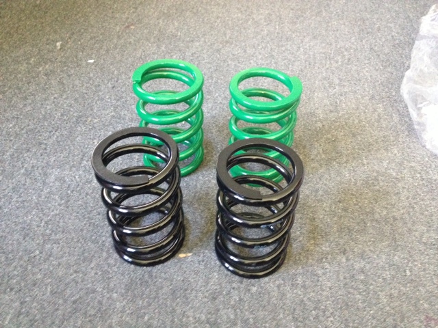

Post by Donovan » Fri Oct 19, 2012 11:07 am
New springs turned up from 949 Racing, Green is 12kg for the front, black is 8kg for the rears.
don't understand the custom charges, got a 2nd hand set of sport brakes, booster, BMC from a wreckers in the states, all up cost about the same as the springs, and have got pinged GST and all their other bit's and pieces on those. Springs didn't get charged anything???

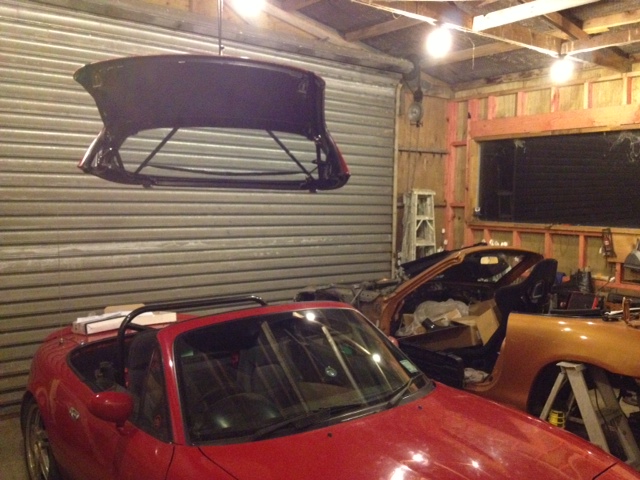

In my hunt to figure out where the fuel fumes are coming into the cabin, I setup the hoist in my barn for the hardtop (only had it sitting around for about a year or more).
Fiddly the first time I went to use it, but I imagine it'll get easier as I figure it all out, and get it lined up a bit better.
Bit freaky working in around the cabin with the hardtop floating over my head, hoping that the thing is going to hold up.

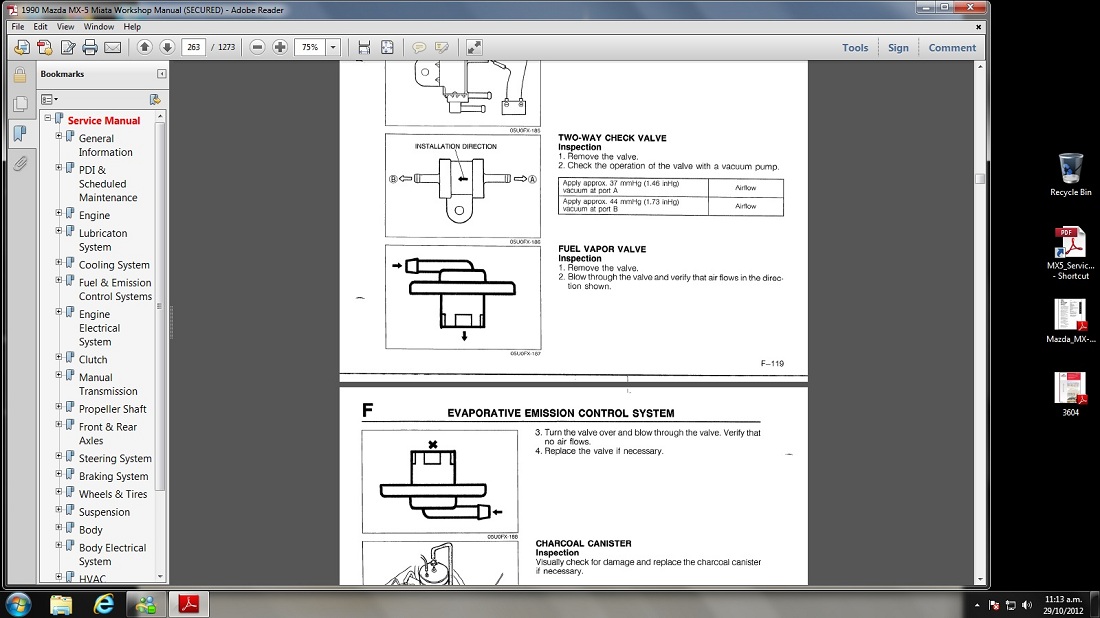

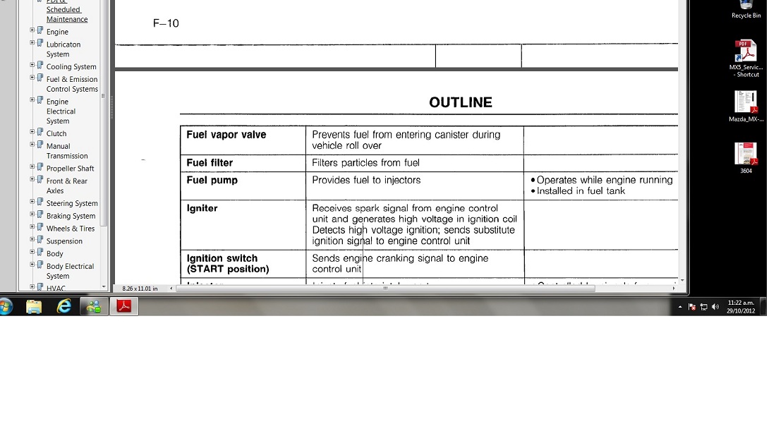

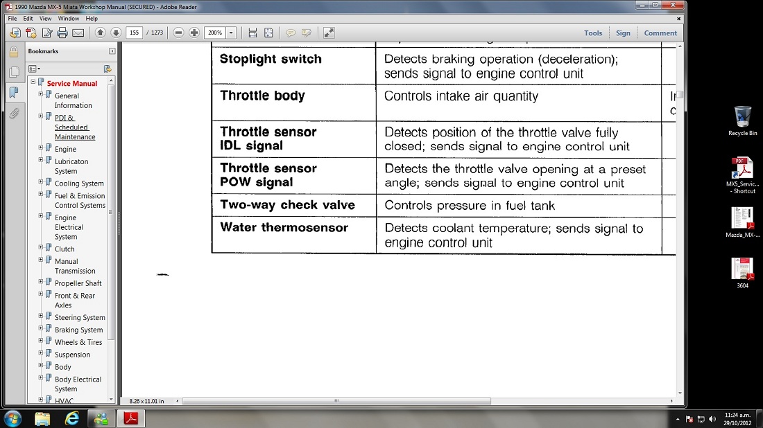

Post by WideOpenThrottle » Mon Oct 29, 2012 11:41 am
Some info for you Donovan...may be of help?
On the last pic '7' is the two way check vavle while '8' is the roll-over valve.

Post by WideOpenThrottle » Mon Oct 29, 2012 11:51 am
I think it would pay to re-install the two-way check vavle if its not there?
Post by Donovan » Mon Oct 29, 2012 4:58 pm
WideOpenThrottle wrote:I think it would pay to re-install the two-way check valve if its not there?
It's number 7, the two way check valve that I shoved in there Friday night, that I pulled out of the NB, but now I am wondering whether it is going to do that much. One of the images you sent thru for the two way valve said to test you need to put vacuum on at either end. Since one end isn't going anywhere other than under the car, there is never going to be vacuum on the point B side in the image. Or does it just mean that it is going to get to a higher pressure in the tank before it starts to vent itself.
