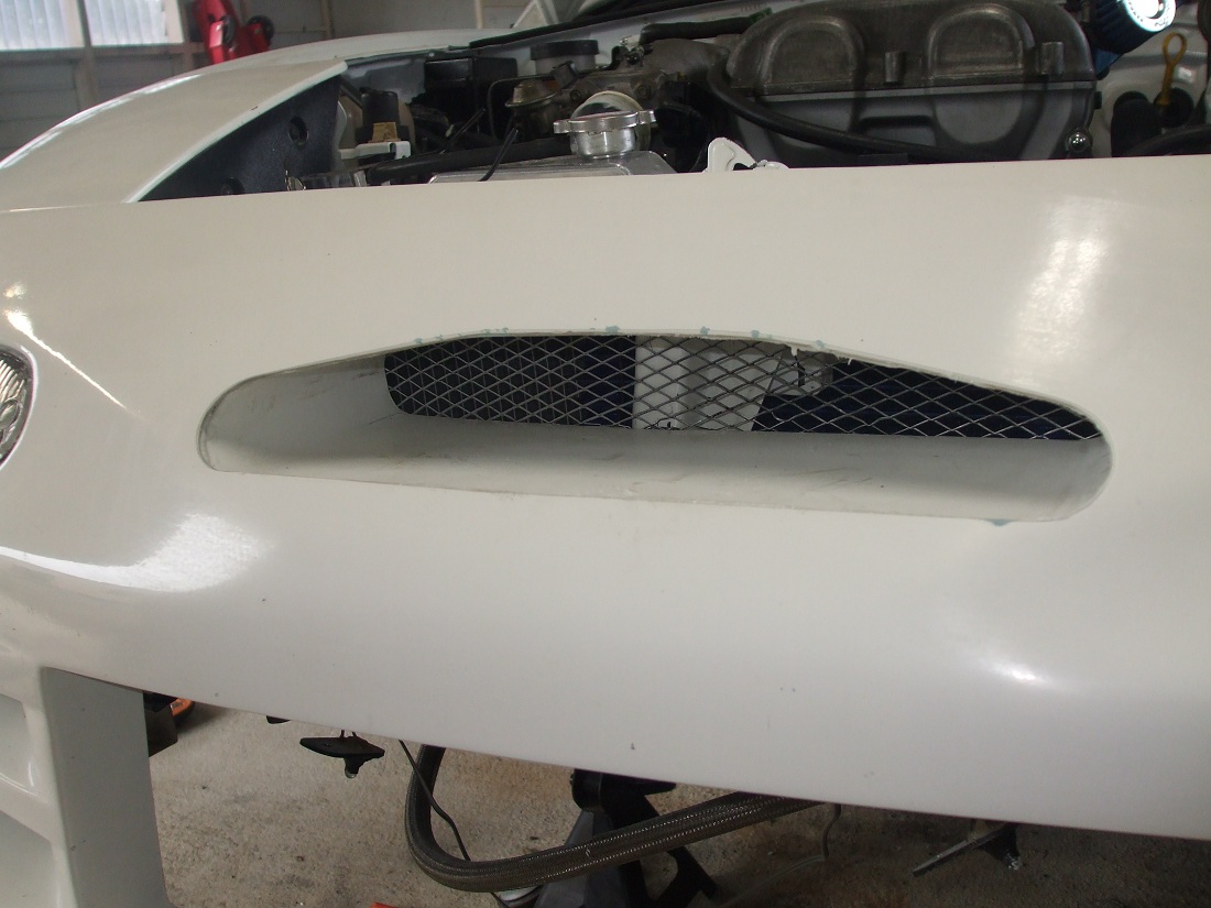

I started my front bumper vent mod to supply air to the oil-cooler & upper radiator.
Thanks to zippy2 for the idea! :D

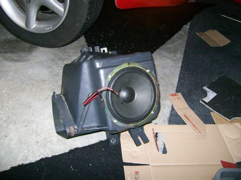

Euen wrote:To do it properly, see if you can find the plastic duct to replace the unit under the dash between the fan and the heater unit.
Makes no difference once you take out the evaporator, save for a 100 grams or so in weight.
Heres an idea though. What I did with the (now empty) evaporator box was:
Cut a 5 inch circle out of the front side.
Fit a 'transfer' pipe (some pvc drain pipe) from one outlet of the box to the other to carry all the air through, sealing the edges.
Fill the inside of the (now sealed) box with a small amount of concrete about half an inch deep, letting it set one side at a time so the box now has half inch thick concrete walls.
Mount a 5 inch subwoofer in the 5 inch hole and an amp under the seat.
Enjoyed the decent bass it now produces from a completely hidden sub!
Picture shows a cheap hifi speaker I used as a proof of concept.

Clever bastard!
With the concrete in does it end up being very heavy?

Narp, bout the same as it was with the old evaporator in it. In fact it's not concrete but tile adhesive. Dries just as hard in the end.
I did have a bit of difficulty finding a 'proper' small sub, but lucked out and got a second hand high end carbon coned job. I am constantly surprised just how well it works. It doesnt drop as low as a 10 or 12 does on D&B tracks, but for punchy music (im more into house), it's perfect!

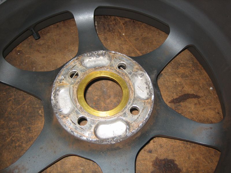

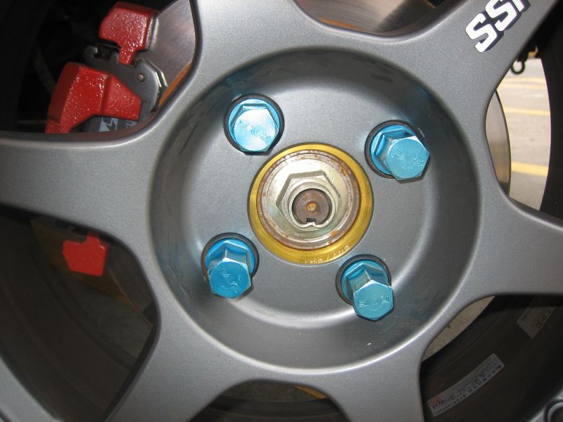

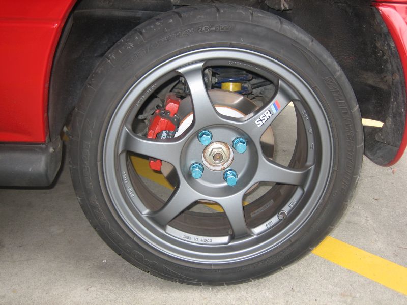

Fit Hubcentric rings in my SSR's that i got from Goodwin racing,mint service and Perfect fit !.

Keen for whole car shot with the SSR's on it. They look tasty.
What specs are they?
Post by WideOpenThrottle » Mon May 28, 2012 2:14 pm
Bwarp wrote:Keen for whole car shot with the SSR's on it. They look tasty.
I like that look too!..[maybe one day] :D
