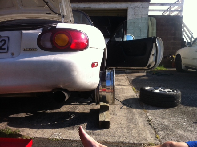

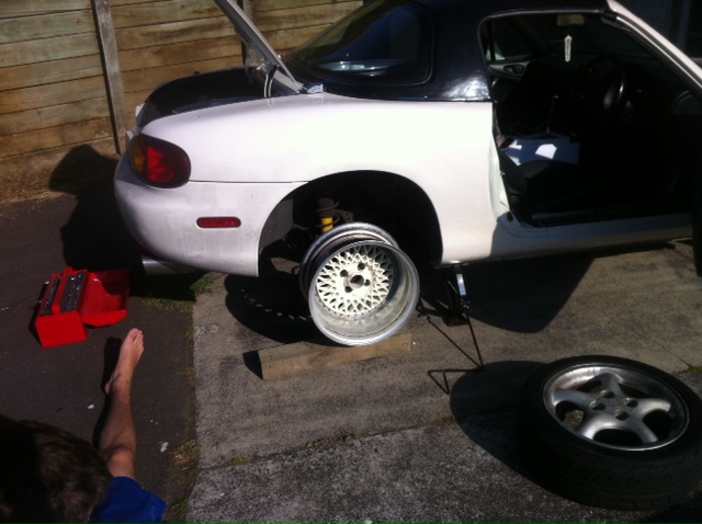

They are currently 15x7 +35 F 15x7 -35 R(For shits and giggles)
And are going to be 15x9 -4 Got some new lips on order

Post by Kieran » Mon Mar 04, 2013 4:38 pm
Im getting some new hubs and bearings with ARP extended studs
also there will be another 2.5" of lip on the inside thats just the wheels with flipped centres so final fitment will sit about there

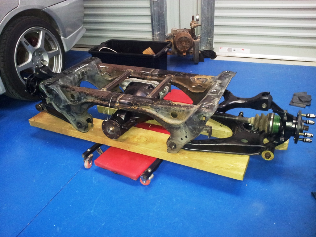

working on rear subframe:
Evo LSD & axles, widened subframe, 4x114 stud pattern, 285mmx20 discs

15x9 -4 isn't that bad I'm going to run as little camber as possible with a 225/45R15 and those wheels aren't very heavy with a turbo it will be fine
Post by Angreal » Tue Mar 05, 2013 10:31 am
I suppose they aren't that big. They just look huuuuuuge :p
Post by Kieran » Tue Mar 05, 2013 11:13 am
That pic shows a 15x7 +35 with a flipped centre disk which makes it 15x7 -35
I will flip it back replace the front lips with 4 inch lips making them roughly 15x9 -10 which pokes the same as the 15x7 -35
I "only" have to find about 80mm of space under the guards to fit them :lol:
