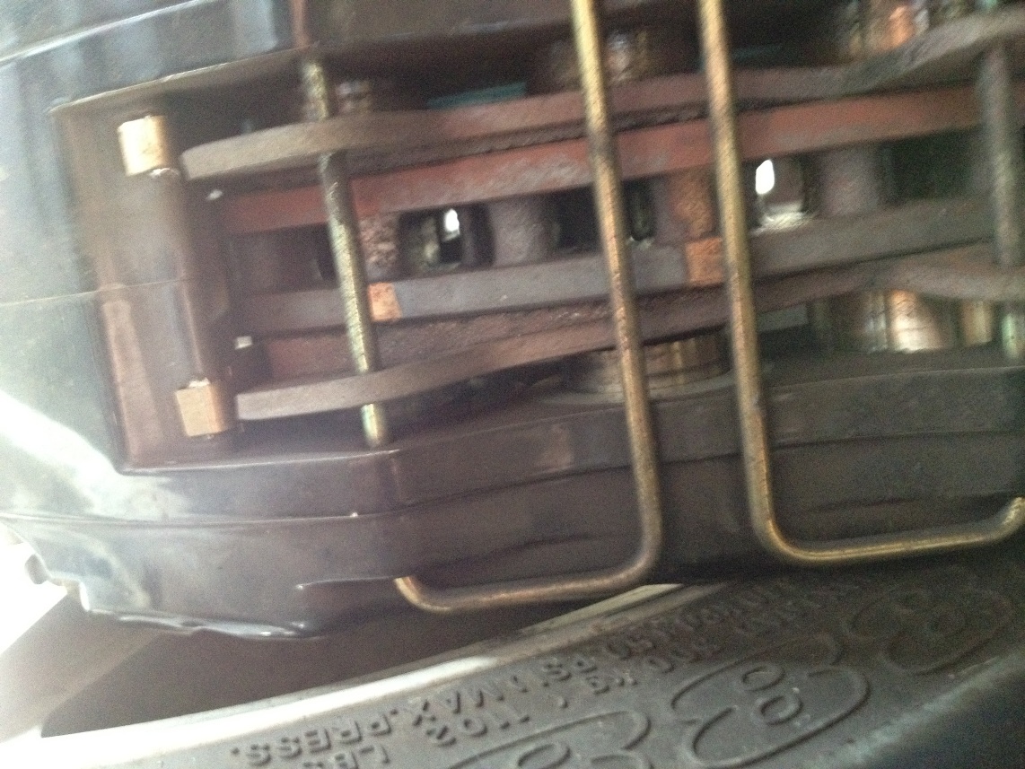

Well the brake saga continues, I have pulled off the front calipers in the process of pulling the shocks out to put beefier springs in there, and when I did that, could see the front half of the pad was worn to the metal, where as the back half still had about 50% left on it.
So now I have a major issue to sort out, either I have some sticking pistons in my calipers, which could have been caused from the fire incident from the first track day, or the other suggestion was, that my whole front suspension setup is shot and all about to collapse on me.

Or the original pads are way too soft...Donovan wrote:Well the brake saga continues, I have pulled off the front calipers in the process of pulling the shocks out to put beefier springs in there, and when I did that, could see the front half of the pad was worn to the metal, where as the back half still had about 50% left on it.

Why would the suspension collapse from braking issues?Donovan wrote:So now I have a major issue to sort out, either I have some sticking pistons in my calipers, which could have been caused from the fire incident from the first track day, or the other suggestion was, that my whole front suspension setup is shot and all about to collapse on me.
...but if it is the standard Commodore one it should sufficient.2low2c wrote:from that photo i would say that your master cylinder was to small and not pushing enough fluid to fill the caliper properly. iwould replace the master with a 15/16 one .
The suspension thing was from Goodwin racing it was his suggestion that this was a sign showing that the hubs or suspensions arms where moving too much causing the rotor to move around which is a sign that the suspension is about to give up.

I'm not sure of the bleeding arrangement on your calipers but my Wilwoods have a bleeder for each piston. If you have air in a piston, it would reduce the pressure on that part of the pad causing uneven wear.

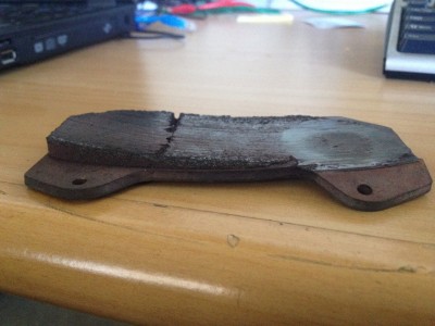

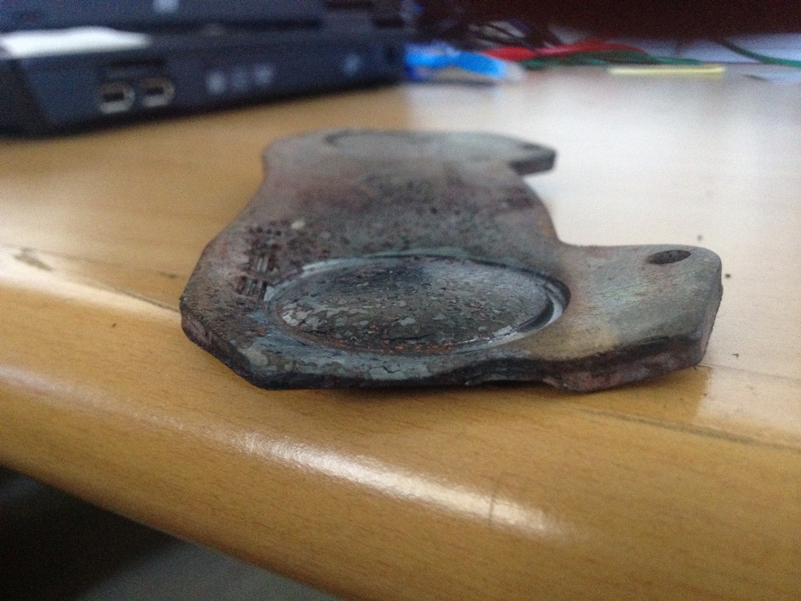

Decided to stop sulking about the brakes and at least pull the pads out and have a look at them. Not the easiest to pull out since they had all warped and bent.

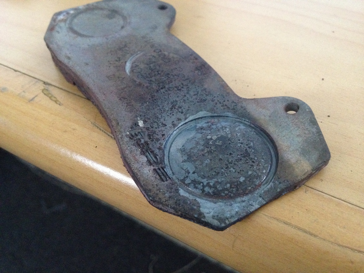

You most likely can't tell, but the piston from the caliper has just about pushed itself thru the metal backing, wasn't far to go.
Seems my calipers are on back to front, they have a left and right side, two of the six pistons are larger than the others, the larger set are supposed to be the trailing ones, at the moment they are the forward ones on the disc rotation. Not sure if this is the b all and end all of my brake problems, but it certainly wouldn't be helping.

Its possible that the pads have only really been 'used' where the larger piston was contacting. With all the brake pressure in one area, they have heated up far more in that area than if the pressure across the pads was even, making them catch fire/warp. The warping of the back plate from that heat is probably what has caused the uneven wear, which then explains why your first set didnt have the same wear. I cant really see how a smaller MC would cause uneven brake piston pressure. From the callipers POV, a smaller MC would just seem like less brake pressure was being applied at the pedal, ie you werent braking as hard.

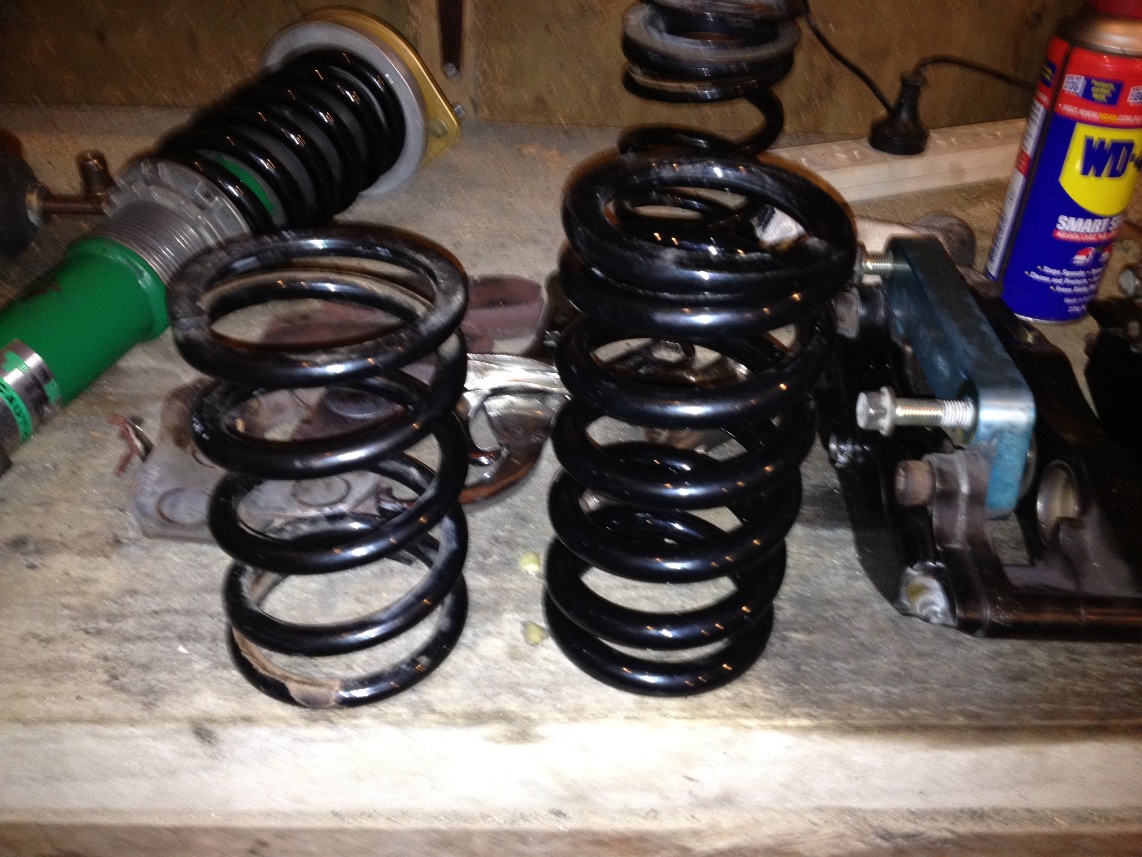

Trying out new front springs, little skinny ones next to big fat replacement ones.
Internal diamater between the two is different, so Keith helped me out, and milled off a couple of mm off the perches of my coil overs.
And yes, bad photo I know.
The replacement ones are taller, but the original ones had helper springs on them which gave the coilovers a greater range of adjustment, I am just hoping that when I put the car on the deck with the replacement ones in there I can get the right ride height, and that I can adjust them with my coilovers.
