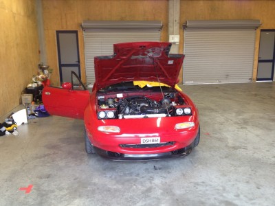

Rightly, firstly a big thank you to Mad Kiwi for helping me work on the car getting things prepped for taking it down to Taupo on Saturday, we spent a couple of nights up to midnight sorting out things, took so long as we were fumbling around and talking shit.
So made up a couple of backing plates for the front brakes with, put a front lip spoiler on that allowed us to shove a couple of 50mm tubing to feed air to the front rotors via the backing plates, replaced the pads, which the original ones were toast, and had only done 1 track day in them!!! Flushed the existing brake fluid and replaced with the BNT branded stuff Euen had used, only cause that was the only stuff they had in stock of more than 1 bottle, which I thought I would need two to flush out, turns out I got away with 1 after all.

Went put the car on the trailer, and then found out it wouldn't get up there with the new front lip on it, even with the Suspension raised to the highest height. Quickly had to make up some ramp extension with 6x2 lying around the place, and managed to get it up on there and tow it down to Taupo.

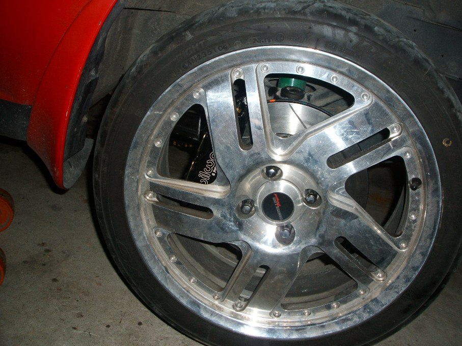

Attached picture is at the Garage there, you will see the ducting pipes sicking out the front for the brake cooling, need to get a proper entry feeder to the pipe made up that should force more air to the brakes.

As Angreal mentioned you may be better off looking at a proper cooler for the PS fluid if it is getting that hot. If my memory is right then I think the standard cooler is just an extra length of steel tubing that loops across the front of the car.
The other thing that may help your brakes a bit (and you may already have considered it) is to fit funnel or collector on the front of the ducts that fits the hole in the front lip to catch as much air as the hole will allow.

Have cooling tube from the NB that I am pulling apart, so will try and get that plumbed in before the next time I take it out on the track, hopefully that is enough to make a difference.
Yes, I know I have to sort out the feeding into the cooling hose, it was a quick fix as I knew I didn't have time to make up a decent set of feeders before the weekend, and figured that just having the hoses poking out the front was better than nothing.
