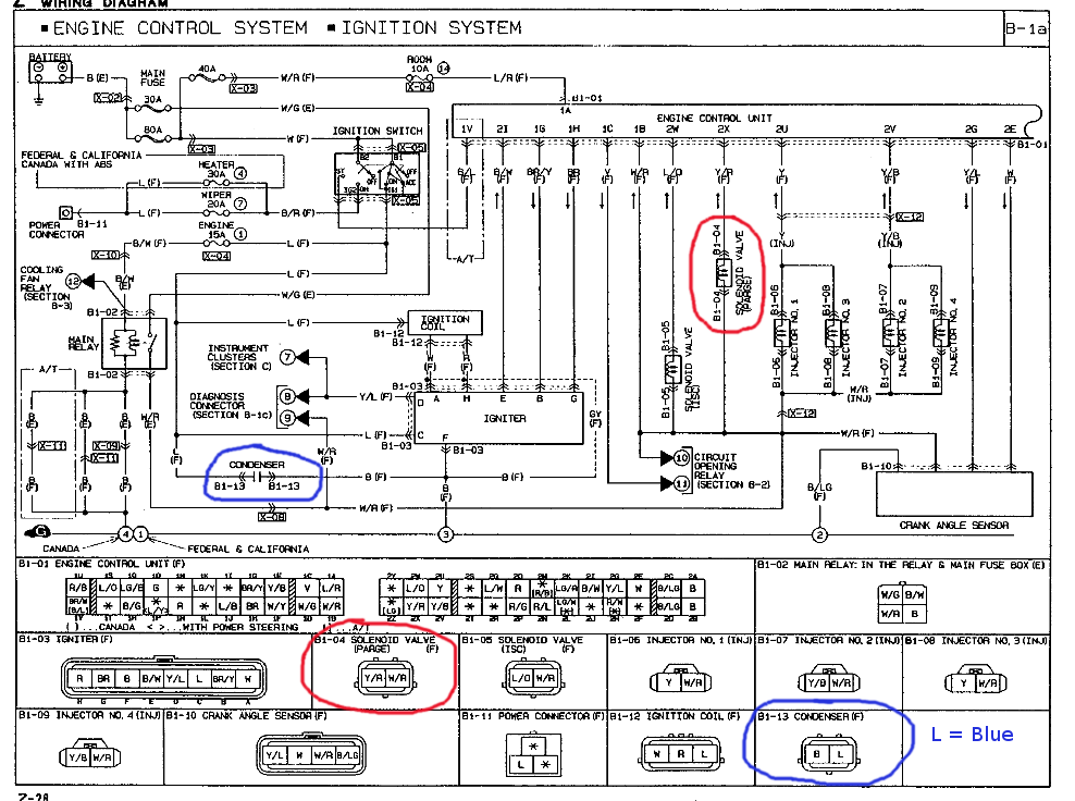

Thanks very much for your help. I've been told that the black, blue wire is charcoal canister, is it possible I've got the 2 wires there (Same plug colour/shape) mixed upmarcellarius wrote:The Blue/Black connector is for the ignition capacitor -- small 1 inch-ish black box with two wires coming out of it. Attaches to the igniter bracket.

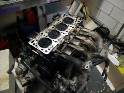

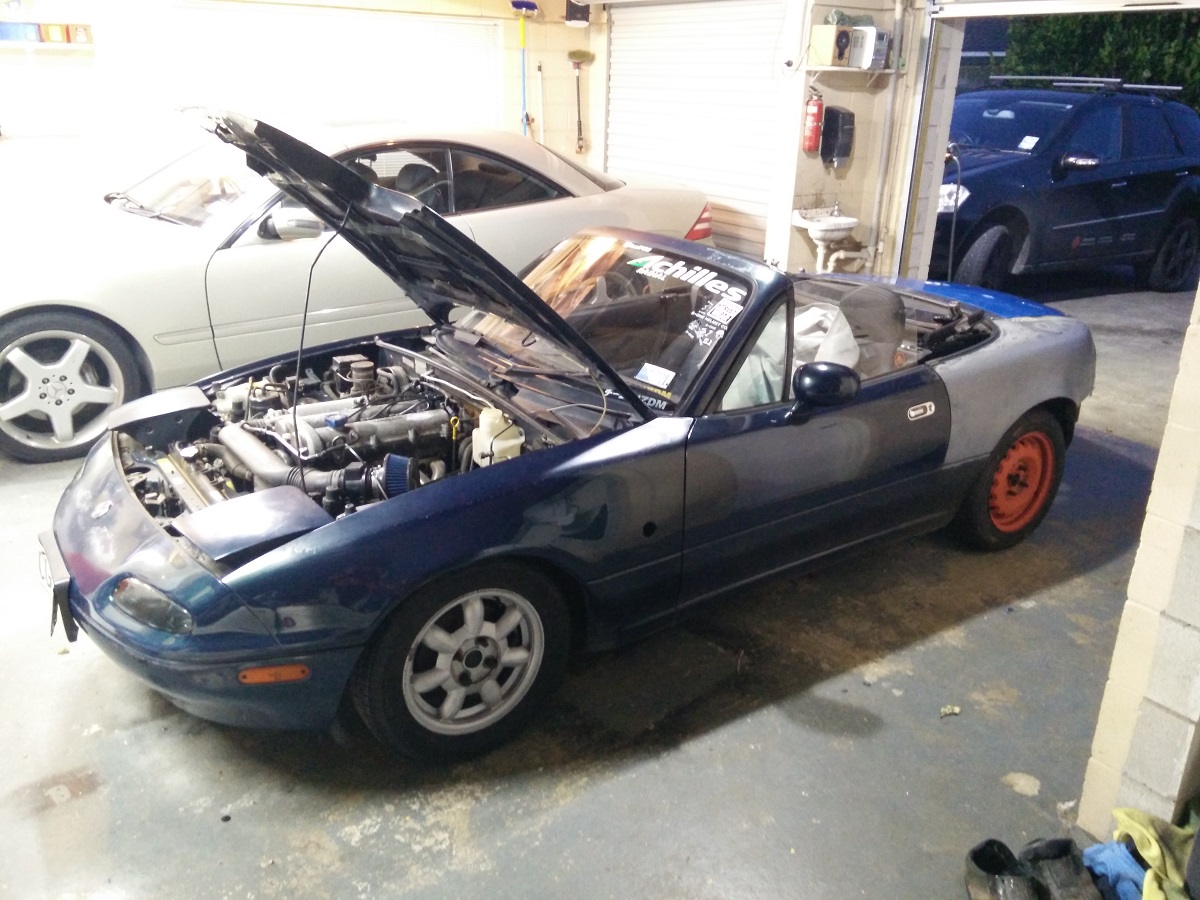

Head gasket
Bought this little turd a month or two ago, I knew it had a blown head gasket or a cracked head so last week I changed the head gasket. The radiator wasn't pressurising after this but it was still billowing smoke out like a mo fo... So at least I fixed one thing! :/ Put a third of a bottle of that CRC Fibrelock in the radiator, and 45min of idling later she is no longer puffing out white smoke!! Going really good now, next on the to do list is get a new set of wheels and weld up a roll bar / half cage for track days!
- Posts: 747
Well ain't this long overdue...
Decided the rusty poo bit of metal on the back of the bumper was too yuck so cleaned that up and threw some black on her. I'm long overdue to get some decent photos up of the car but that will happen soon enough.
IMAG1007 by Jarred McLachlan, on Flickr
So where to start? I have sorted all of the plugs, some confusion arose around the earth on the back of the intake manifold and which plug this was, sorted quite quickly luckily but I was actually missing the bracket on this manifold so unsure how the loom was laid out before.
IMAG1008 by Jarred McLachlan, on Flickr

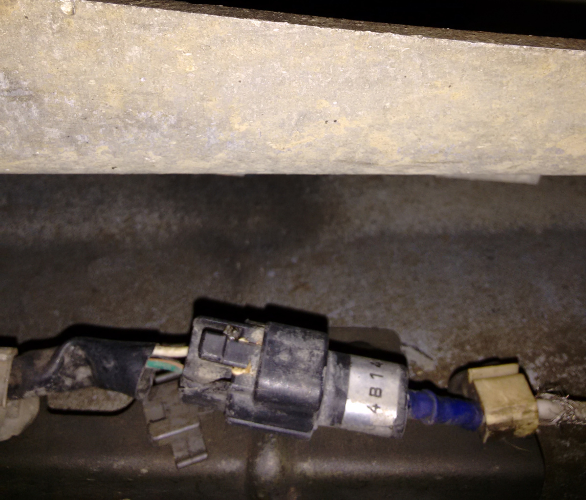

Found this but it's only the temp sensor, some heat shrink and solder solved that.
IMAG1065 by Jarred McLachlan, on Flickr
I had reached the point I'd tested spark and leads and both were fine, had also tested fuel and also was seeing it at the hard lines so all that was left was timing, vacuum or injectors. I knew the injectors were OK as they'd been tested so assumed my wiring was out. Voltmeter told me it wasn't so went back a step.
Changed plugs for the correct temp range. Had 2x BKR5's and 2x BKR6's. Rando.
IMAG1064 by Jarred McLachlan, on Flickr
All of the OCD has been worth it when I look at shots like this...
IMAG1015 by Jarred McLachlan, on Flickr
IMAG1014 by Jarred McLachlan, on Flickr
Now if you would be so kind as to click below with your sound on.
https://www.youtube.com/watch?v=LThLD51 ... e=youtu.be
I'd got the old bitch firing last night but had a major fuel leak thanks to these.
IMAG1070 by Jarred McLachlan, on Flickr
Replaced and away laughing. Anyone who's been talking to me recently knows how stumped I was as to why the car didn't start. Basically the bracket that holds the hard lines to the chassis had been flipped 180 when I put it back on after painting so my return and feed were backwards. I had undone this to test them and did it back up after the same way so it appeared I had fuel, but I was running it backwards through the rail.
Now simply to bleed the brakes, clutch, align the clutch pin to master cylinder, gearbox oil, alignment and WoF/Registration...

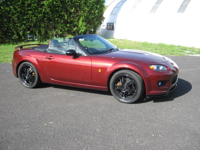

nc
Just got my 06 RS finished.
Mazdaspeed front and rear bumpers.
Mazdaspeed boot spoiler.
BC gold adjustable suspension.
Led day running lights.
17" Manaray wheels.
We had the quad exhaust made as the single factory outlets looked a bit small in the bumper cutouts.
Resprayed the whole car and thought we would make it a bit different than all the other NC,s out there.
Mirrors and windscreen surround were painted gloss black along with the wheels,badges and bumper bases.
I like the 2 tone look.
Frt bumper inserts were modified to suit the led lights which work of the key so they cant be left on.
