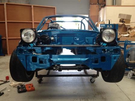

Post by REDBEN » Tue Dec 09, 2014 8:49 pm
Thanks to Sprsta we Finally managed to get some colour on to the bare chassis right before Christmas! Super stoked with the colour choice and the overall quality is second to none! Thanks again Cole you're a top bloke!
Photo's do not do the finish quality any justice!!!!!

Post by REDBEN » Tue Dec 23, 2014 9:09 pm
Yus I like the blue cage its super tidy! Thanks to Cole!

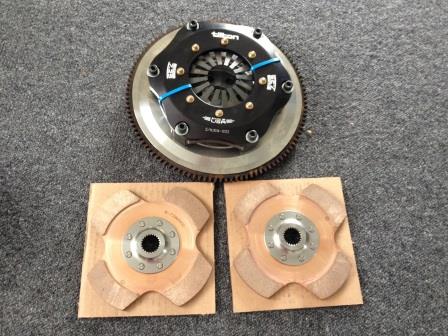

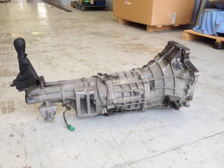

We have had the Cusco 2way Differential stripped inspected and rebuilt by Kayne Barry Motorsport which is now in perfect condition for hardwork a head. To add to Drive line updates we are also sporting a new NB 6 Speed gearbox opposed to the NA6 one. To help get the power down I chose a Tilton twinplate clutch and custom flywheel setup from MRP at the same time I ordered the new BHJ Dynamics Crank Harmonic Damper. We are hoping to build the block over Queens Birthday weekend and have the car rolling by September.

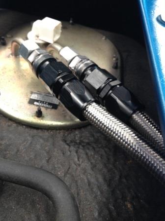

Also Began running all the braided fuel lines and updated the Fuel pump to a TRE lift pump which inturn will supply the surge tank located in the boot.

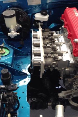

Got some more time on the Machine Centre yesterday so finished machining the plates for my ITB plenum. All ready to go to the Fabricators and get the hand formed plenum made. Much Excite. :P
Post by Furai » Sun Apr 12, 2015 9:10 pm
ITBs are just engine sex
