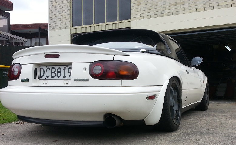

I installed a new R-package lip on the rear, I bought it from Dylan Nielson and unfortunately the smaller piece was cracked but Dylan is going to replace it so that's really awesome :)

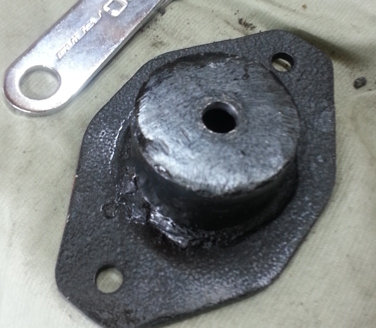

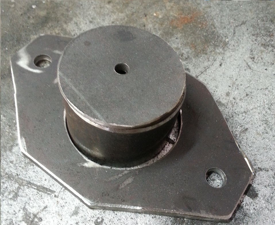

I also made some new tophats for my BC coilovers so that I can finally go almost properly low, or low enough.. ;) I made then 1 and a half inches high to go on the rear, the rear tophats I then put on the front. It really does look soo much better although I'm going to have to get the front guards pulled a little as the tires brush against the top of the guard when I'm turning and under a little bit of pressure.

Jesse, did you cut your mud flap or lip? Looking good, tho.

Thanks man. Yeah I cut the mudflaps as I figured they are cheaper to replace than the lip if I ever need to. :)

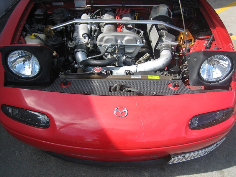

Post by brownie » Sat Nov 08, 2014 10:41 am
Cooling panel fitted today here at work,
(Quiet Saturday and no boss in today)
REDBEN ,what are the black tubes for on the screws ?
Hydro printing it came up mint

Brownie,
They are interfence fit spacers to level the cooling panel out, theyre tight on the screws because you cannot get your hands inbetween the panel and bumper.
PM me if you need further assistance :)

Is that an ARC Super Intake I spy?
