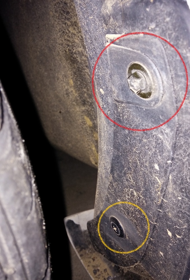

The bracket can be seen here: http://mx5cartalk.com/forum/viewtopic.php?f=28&t=51665
The bracket has two screws. One naturally to fit to the underside of the car.
In the picture can be seen a 'channel'. The second screw attaches to a piece of plastic which is slightly angular to fit the channel. It's this bit I don't know how it fits to the car.

Ah gotcha...alisam wrote:The bracket can be seen here: http://mx5cartalk.com/forum/viewtopic.php?f=28&t=51665
Here's a pic of the bracket on mine. Excuse the filth... she hasn't been cleaned in awhile
