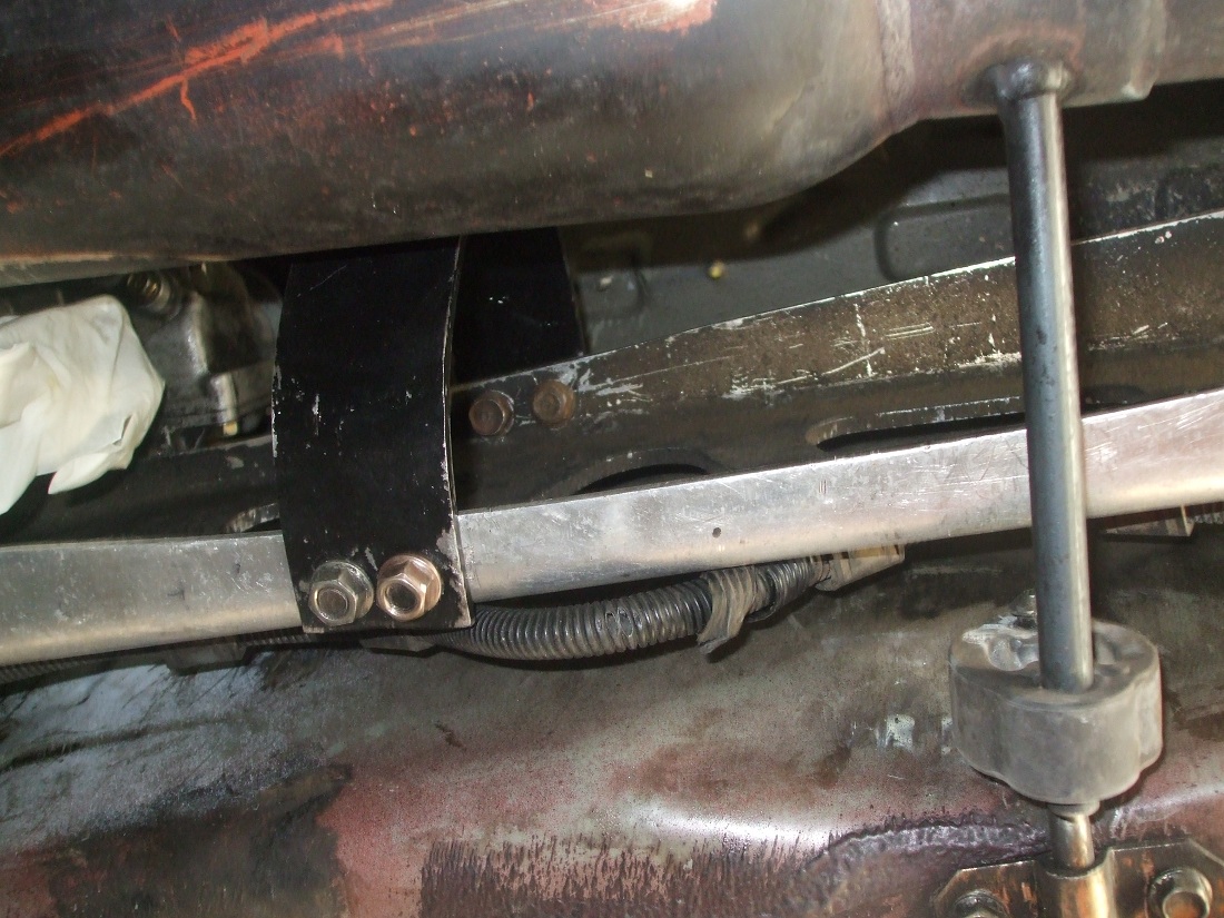

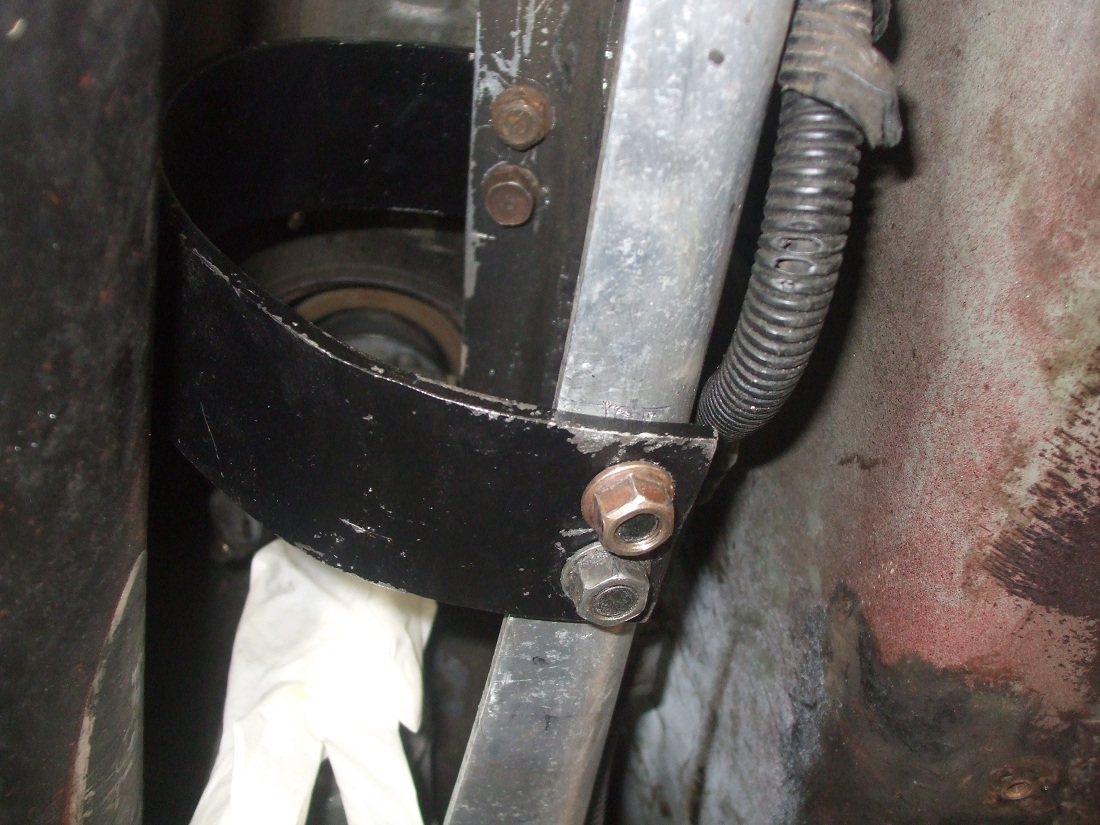

Here is a pic of mine and you need four bolts of shaft diameter of 10mm which can be either 14mm or 17mm socket head.
http://www.lvvta.org.nz/documents/infos ... cation.pdf
