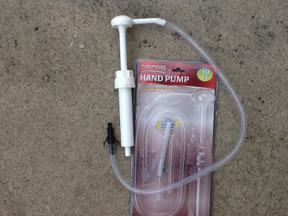

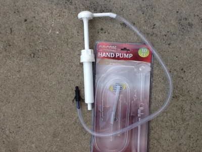

I bought a cheap one from Supercheap on a whim once. I never expected to find so many uses for it!
Oil pump
Post by GRUVBB » Wed Aug 28, 2013 5:55 pm
This is the one i got from either super cheap or repco. It only cost about $6. It attaches onto the fluid bottle. Did my diff and gearbox with it. Paid for itself instantly by removing access aggrevation. I even went to buy a motorbike recently and it had no gas in its tank as it had been sitting for some time. No Probs. got the pump out of the boot as i had only just purchased it in preperation of doing fluid changes. Used it to pump some fresh fuel out of sellers boat. Worked a treat. Seller was off to buy one next day. At that price you cant go wrong. [/b]

Yea I believe it was from supercheap.
The first time I did a diff oil change, I did it using a garden hose running out the wheel arch, was all sorts of messy and painful, these things make it heaps easier.

That pump is brilliant. Never used one to drain oil before, can it be used to syphon? Would solve my siezed drain plug on my diff.

Im not sure if my one needs to be sealed onto a bottle. Ill try adding some flex piping to it and see if it will suck in static pressure.
Another option to drain oil is toinsert a bent pipe into bottom of diff housing and then pressurise cavity with air compressor. The pressure will force the oil out via your bent tube :idea:
Post by marcellarius » Thu Aug 29, 2013 1:09 pm
I've never used mine sealed in a bottle. It was super handy for filling my diff, and I've since cleaned it out and it makes emptying a brake or clutch reservoir much easier.
Putting a hose on the end of it sounds like a fantastic idea.
