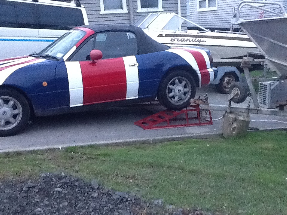

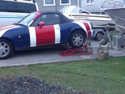

Finally got around tuit and completed fuel drain. Took Ross advice and removed drain plug. Handy parking on a hill at times if you have the right gear. Car ramps to elevate the rear of the car as i could not get hold of an olsen twin to slip under for me. Removed drain plug and filter and replaced with a new on for piece of mind. Filter cost me $34. I could not be bothered trying to find one cheaper as it was just up the road. Added fresh gas and primed fuel lines thanks to Gary information. Turned the key and car jumped back into life. Has been sitting or at least a month neglected. My new toy a CRF has taken precidence for past 2 months. Off for a WOF tomorrow amd we are cruising again. Fingers crossed that is. May get snapped on a hazy boot lens. Ordered a replacement anyway from Ross.
