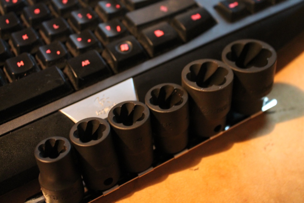

A friend has some special sockets which should be able to get the bolt out

tomtikki wrote:Don't forget to sort new bolt/s beforehand so you don't have to muck about when you go to chuck your seat back in. -its the sort of thing I always forget... :roll:
Glad i just saw this post. Friend leant me these koken nut/bolt extractors tonight so ill have to find a replacement bolt before attempting removing the seat again.
Post by tomtikki » Tue Feb 12, 2013 6:26 am
To be honest I don't think I could wait to use those 'sockets', they look kinda mean!
Whatcha do with them? -hammer them on to the bolt so it cuts into the head to give grip or something??
