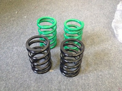

New springs turned up from 949 Racing, Green is 12kg for the front, black is 8kg for the rears.
don't understand the custom charges, got a 2nd hand set of sport brakes, booster, BMC from a wreckers in the states, all up cost about the same as the springs, and have got pinged GST and all their other bit's and pieces on those. Springs didn't get charged anything???

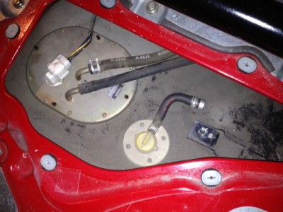

So with the hardtop swinging over my head, pulled off top over the fuel pump trying to locate where the fumes are coming from.
Any how, discover this. I figure the 3rd pipe is the breather line for the fuel tank, that now goes no where and is blocked off.
Not sure this is contributing to the problem or not, but if the breather line is blocked, then what is stopping the tank from sucking itself in as the V8 drinks itself silly

whats it blocked with? could be like the gearbox breathers by the looks
Post by Angreal » Thu Oct 25, 2012 8:39 pm
It does look like it's venting from the photo. There's lots of dust and then a clear cone extending away from the hose which might indicate it's releasing vapours.
I'm no CSI, but that's how I interpret that photo

It would be unlikely that Mazda would go to the effort of adding a union and pipe to the tank, only to block it off again. This could very well be the breather. I can already see a send and return line on the pump so it cant really be anything else.
Contrary to belief your tank will probably be under positive pressure with the breather blocked, especially once the car is warm. This might be why you are getting the fumes. With the tank being overpressurised, the vapours might be finding their own way out of the tank and into the cabin.
I would consider replacing the breather, venting the hose down to under the car but ensuring that you use a gravity dependant non return valve (usually a ballbearing in a box arrangement) in case the car rolls. If the valve isnt there, then if the car rolls, fuel can leak out of the breather.
Hope that helps!

No, there is another valve, as the pipe out of the tank goes into a one way valve, and then into a line which normally runs to the charcol canister. I have pulled the valve off the NB wreck that I have got, and put it on, and then got a length of hose and have run that under the car and out halfway along at the moment.
I think it has made a difference, but I can't say for sure, because since we actually had a fine weekend, I pulled the hardtop off the car and enjoyed a bit of sun.
I still have fumes in the boot, but not sure whether that is from residual that has soaked into the carpet or not, so going to have to try and air it out.
My other concern is, whether a seal around the pipes for the tank has maybe loosen up with the pressure trying to escape out, and maybe I should look at pulling the pipes off and putting some sort of sealant around them?

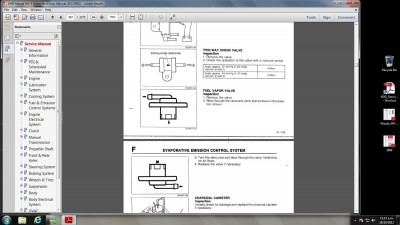

Post by WideOpenThrottle » Mon Oct 29, 2012 11:41 am
Some info for you Donovan...may be of help?
On the last pic '7' is the two way check vavle while '8' is the roll-over valve.

It's number 7, the two way check valve that I shoved in there Friday night, that I pulled out of the NB, but now I am wondering whether it is going to do that much. One of the images you sent thru for the two way valve said to test you need to put vacuum on at either end. Since one end isn't going anywhere other than under the car, there is never going to be vacuum on the point B side in the image. Or does it just mean that it is going to get to a higher pressure in the tank before it starts to vent itself.
When I took the bung out of the pipe that was there, it was hissing away venting until I shoved the valve in, and then it stopped. When I open up the fuel cap, it vents for a good 5 or 6 secs, is that normal, or should it just be a short fizzz.
