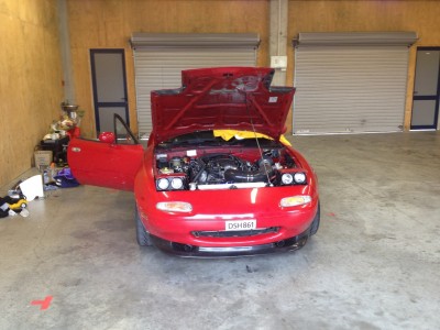

I have used the Hella 90mm for my low profile lights, and the attached photo show them when they are popped up, the height. It works out to be less than half the height of the standard light.

Donovan, your's looks pretty damn good, how did you make the mounts and covers etc?

Post by Donovan » Tue Sep 18, 2012 4:27 pm
Mr Revhead wrote:Donovan, your's looks pretty damn good, how did you make the mounts and covers etc?
It was based around a kit out to the US, just had to then buy the right 90mm lights, which after much searching around, cheapest was again out of the US, which was strange for a RHD car.
