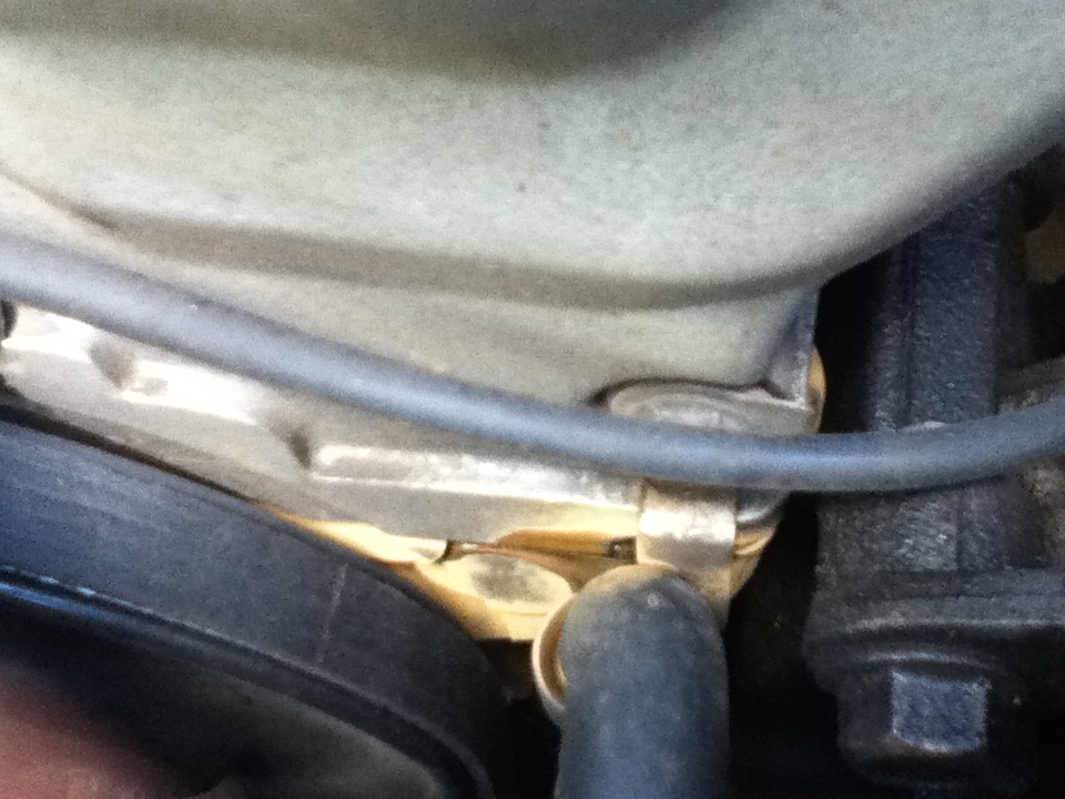

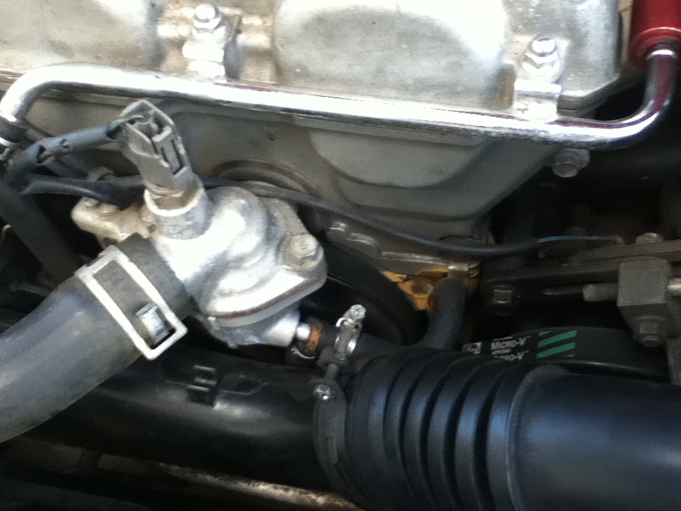

Look what I spotted this morning :(
Reckon it could be the water pump seals?

Sorry I should have elaborated a bit more. There is water leaking out of the cam belt cover. When I rev the engine it drips a bit faster.

I would say your diagnosis is pretty accurate, only other option I can think of really is the edge of the head gasket has blown out and is leaking some water out the side but that is much less likely.

Can see the top edge of the water pump there, looks like the seal has gone on it. Is it leaking from behind the pulley or the edge of the casting?

my water pump was failing around it seal. wasnt dripping but the pulley was wet. prob just the water pump. (was it changed when th ecambelt was done??) if you are around the 150K mark and it wasnt done at the cambelt change then its a good bet its shagged.
