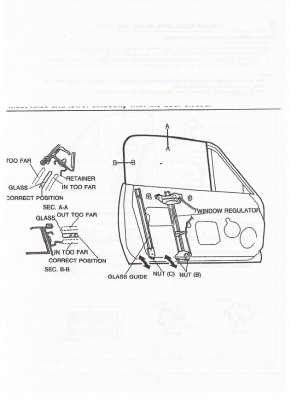

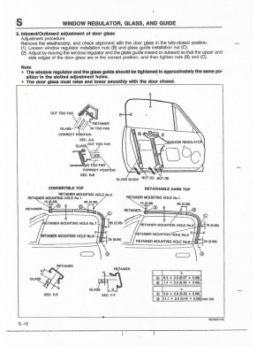

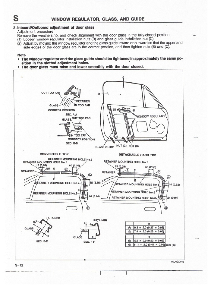

OK so I tracked down that file, managed to get past the password, strip it from the file, reupload it ... Is it worth posting the link here?
Also, appreciate the tip, it looks like a HUGE wealth of knowledge in there. I'll be tackling the door tonight. After last nights downpour, I'm keen to get it sorted

https://docs.google.com/open?id=0BxtKTq ... TE3R01tQVE
Google Docs complains about it not being able to scan it with Antivirus or being able to display it in the web browser, but I've tested it on another PC and it works sweet as
Hope that helps
Hope that helps

Great to see its all worked out...must've made it harder to view since i got it a few years ago!Chilling_Silence wrote:OK so I tracked down that file, managed to get past the password, strip it from the file, reupload it ... Is it worth posting the link here?

Thats odd Fleur, you should be able to. If you click on the Google Docs version, it'll first complain it's too big to preview it within your web browser, but you can still hit the "Download" button.
Then it'll say that it was too big for Google to scan it for viruses, but if you hit the "Download Anyway" button it'll let you
Because it's such as massive file, you'll need a semi-decent PC to open it, or otherwise it'll look like your PDF reader has just hung. Give it time to open
