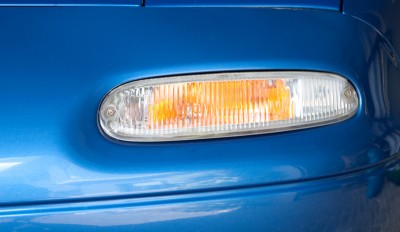

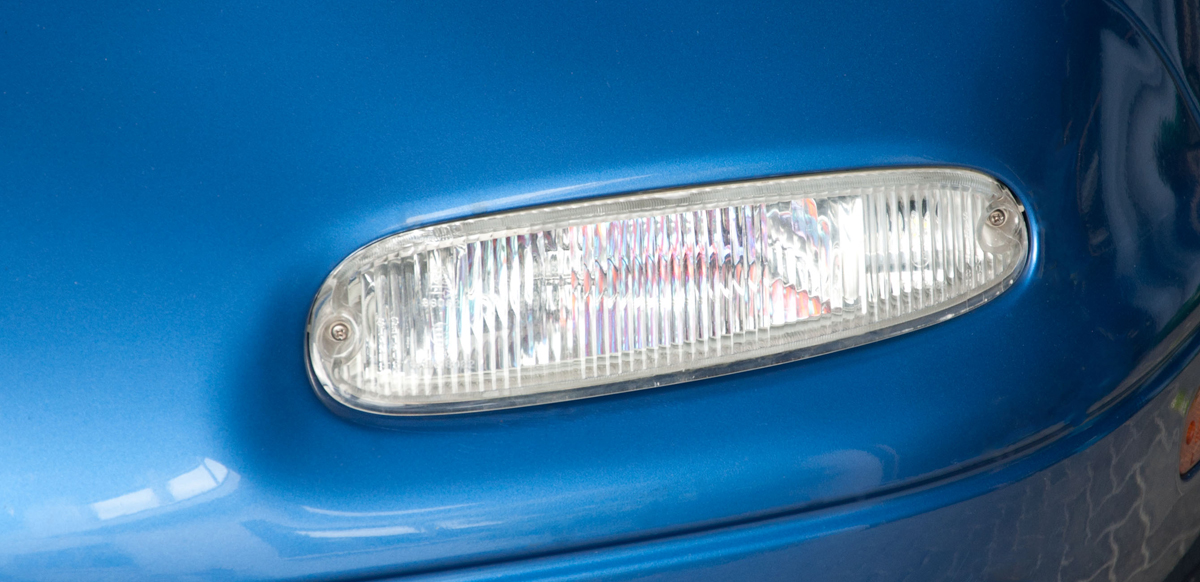

Today was spent taking the front lights apart to remove the orange indicator lens. I replaced the bulbs with chrome/orange and the park lights with 9-led's which are much brighter.
Before and after photos!!
A job well done, i used the misses hairdryer to warm the sealant then gently prized them apart, keeping the hairdryer running!! All good, will add some night shots up later!!
After
Before

The chrome amber build was from Supercheap, the pins where slightly off-set so just filed one off to make it fit the plug. LED Sidelights were also from there. Yo can buy cheaper from the net, but it was one of those couldn't wait things i wanted to do.

i did that mod too with the chrome bulb...just filed one of the tabs off the bulb....hasnt fallen out .
