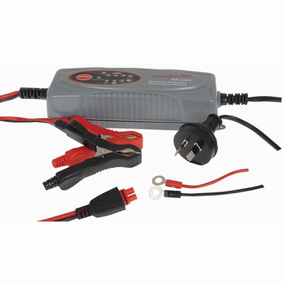

Hi Ian... don't consider it really 'dead' until you have tried a proper charger designed for AGM batteries... you really need to charge at a slightly higher voltage for a long period to get good use out of it if it has recently been depleted. I've seen very old panasonic batteries come right back to life from nothing with a proper charge cycle.
I have one of the below... and recommend it - it has a 14.7V output and you can leave it permanently connected (for people like me who don't get out enough...!).
http://jaycar.co.nz/productView.asp?ID=MB3604
If battery is completely dead, this won't start though, and I use a basic 4A charger for half an hour to kick the battery into life then charge with this one.
Jaycar 5-Stage Charger

I actually have two Projector auto chargers (0.5 amp and 4 amp) which can be left permenantly connected, though my current storage garage has no power dammit! Have regularly used the smallest of these in the past with considerable success, so have the Panasonic on it as we speak and may have revived it!
