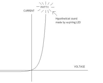

Dimming LED's is not that simple
The following is taken from a very good article
http://www.mikesflightdeck.com/led_dimmer.htm
LEDs : Cool Light
Light emitting diodes are an inexpensive source of light for instrument,
panel and task lighting. They offer a choice of colors and even "white" LEDs
are now affordable. They have no filaments to burn out, and efficiencies
have grown to the point that some are amazingly bright.
Sometimes so bright, you'd like to be able to dim them.
Less current : less light
LEDs are current driven devices. Fewer amps in means fewer photons out. But
we don't generally power LEDs from a true current source. The vast majority
of power supplies are voltage sources, and that's what we usually find
powering LEDs.
Of course, it's not quite that simple
The relationship between current and voltage in an LED is non-linear. As the
voltage increases from zero there is only a trickle of current and no
noticeable light. At about a volt and a half (we're talking red LEDs here)
the current begins to increase appreciably and the first glimmers appear. At
two volts the LED is bright and with a fraction more it's very bright. Once
over about 2.2 volts, the current rapidly soars beyond safe operation. The
LED soon overheats and dies.
