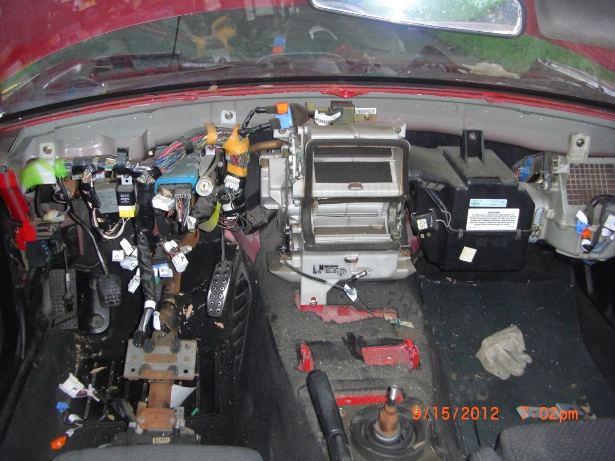

When you says the previous owner deleted the A/C, how much did they take out? There should be a big black box behind the passenger's glove compartment. This is the A/C evaporator. If they removed or modified this, the air from the blower might not be getting to the heater unit.
