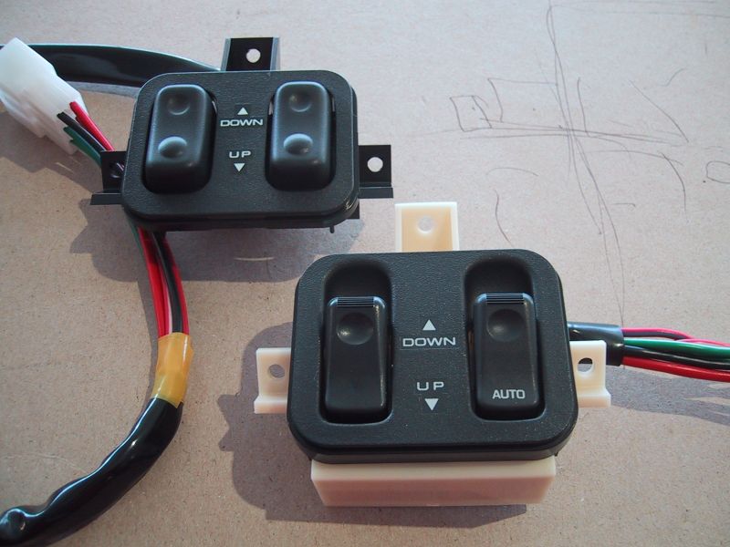

Post by mazline » Mon Sep 21, 2009 4:15 pm
They were facelifted 92-93, went front a rocker contact type switch to a micro switch which you can't really clean up.
Post by Timmo » Mon Sep 21, 2009 6:56 pm
Im assuming that the lower switch is the later one? In that case I actually have an earlier switch installed.....but as noted the contacts are too far gone to just clean.
